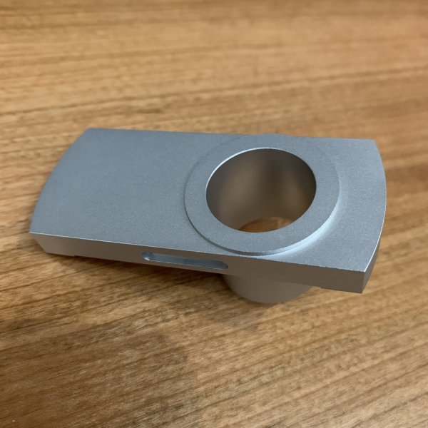

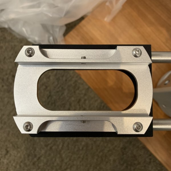

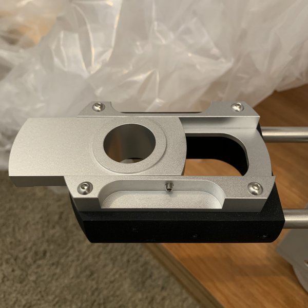

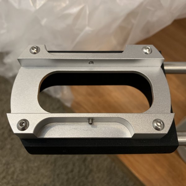

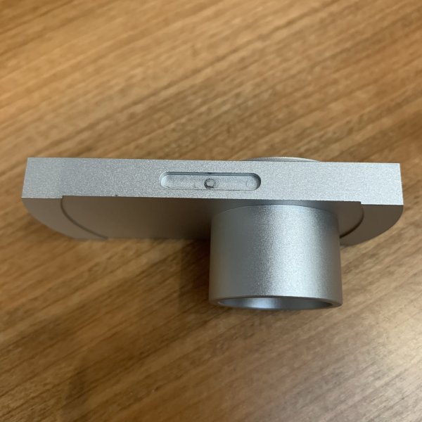

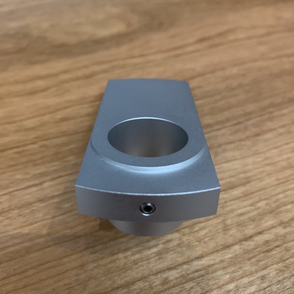

The sliding base is two pieces as you would expect. One piece mounts to the plinth and the other piece to the tonearm stalk. These two pieces mate together for the sliding action. There are two tiny set screws which lock the two pieces together once you slide the base into the position you want. Before I assembled this I noticed it’s a hard metal (set screw) to soft metal (base plate) interface. Because of this I was very gentle torquing the set screws. Got ready to use the arm and noticed a serious wobble at the base plate. Naturally I thought I put the screws in too loose so I tightened them up a bit, but not overly so. Still had the wobble. I emailed AC and they said I put the screws in too tight which dug into the aluminum base plate and caused the two pieces to no longer sit flat. I knew this wasn’t the case since I went gentle the first go around. I looked at the base plate and there were some minor marks where the screws landed. To prove their point wrong I removed the arm completely and put the sliding part of the base into a new position where screws had never touched. Still had the same issues. I showed them a video of me holding the base plate with the set screws locked (under no strain of a heavy tonearm mounted) and it rattled like crazy when I shook it in my hand. They agreed that wasn’t right but had never seen it before. They offered to send a new base plate when my EasyVTA shipped, but as mentioned it’s been months waiting on that.
I’m not a mechanical engineer but to me there seems to be a design flaw in the base. The two set screws are directly opposed to each other at the center point of the base. This seems to create a pivot point, like a teeter totter, if there is any slop at all in the interface between the two base plate pieces.

Interesting as it looks very well made....better that the 3012R.
The quality of the materials and machining of the GMII is quite nice. The headshelll connector and the arm lift are better than other arms I've used. Not sure what is wrong with my base. I just looked at it again for the first time in months. The sliding piece does not fit flat in the base and there is slop to it. The opposing lock screws are not helping matters any. You can see how it creates a pivot point. It's crazy how much the arm rocks back and forth once that slight fitment issue at the base is translated up to the arm.
