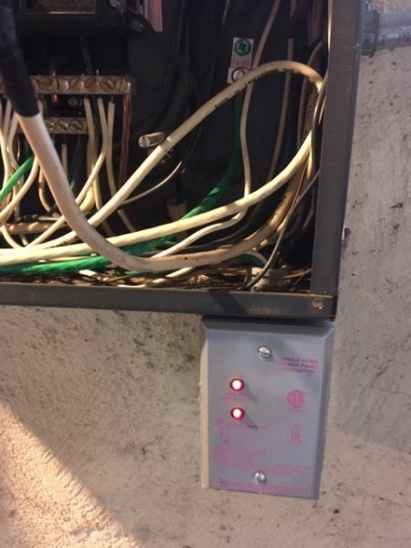

Thanks for the reply. Could you ask Gryphon their policy on electrical panel surge suppressors? Is there any problem with using one?
My friend, whose father was a commercial electrician, recommends that I have one installed on my panel to protect everything from surges. I have attached a picture of one model of surge suppressor. He said:
“Finally got to work on my panel pulling a new circuit. Here's the surge suppressor hanging off the bottom. It's in a standard sized outlet box and runs into a 20A dual pole breaker. If you don't have a spare slot, it just needs to cross both poles (i.e. 240v) at 20A or higher and can sit on an existing breaker (AC, range, or kitchen circuits rated @ 20A).
These come in various form factors, and all the major panel/breaker manufacturers make them - some go right into a breaker slot or can live in empty space inside the panel. ”
By the way, my amp is on one dedicated 20A circuit and all the source components are on their own 20A circuit.
Thanks!
Larry

"We do not really have a general opinion on surge suppressors.
If it has the required capacity (+headroom) - and doesn’t affect the performance of his system negatively, it might save his equipment the next time.
Some surge protectors are connected in parallel with the mains, thus shouldn’t affect the performance. But it might be an idea to try disabling the surge suppressor to check the difference. "
Thanks!
Larry

Sorry for the tardy reply. Here is Gryphon's response:
Thanks Phil! I will investigate further. I'm going to talk to my electrician and my friend about getting a panel suppressor installed.
