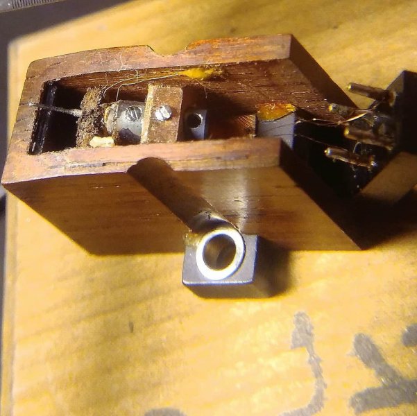

Looking at your pictures in your post, my guess is a Rosewood or Rosewood Signature. The important part would be to find the body which may be inside a Koetsu box. Which leads me to a most puzzle question - why would the owner remove the body or have it removed. Firstly, it's not an easy job by any means. I've seen some open bottom Koetsus and wires are even glued to the inside of the body. Secondly, removing the body defeats the design philosophy of Koetsu in the body as a sort of resonator to its sound as evidenced by where various materials used for its body. Thirdly, the wires are now flying high and low and it seems like they would even touch the vinyl surface. Hope you can locate the body, that's my only advise for now. Good luck.
Those were the questions I asked myself as well. I spoke to the store and sent them a picture of the wooden box and they confirmed that there wasn't one in the boxes of belongings. So the poor thing may be lost forever .
My main reason for questioning the model was the silver wiring and silver coils. I thought that only the platinum and urushi models came silver. But the lack of a P in the serial number and holes not being threaded made me think it might not be.

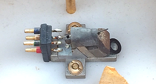

Here's hoping that the guy who removed the body did not 'modify' the wires too. I found a picture sent to me by a customer who's house got flooded and his entire rig got submerged in water. He opened the gold plate to check the wires and looked intact. Notice in the picture the wires are glued to the rosewood body. And the wires don't look silver.
Looking closely at it I see a small amount of the glue that I assume attached it to the body. But the solder looks factory and I can only hope that it hasn't been too touched(except by a moron with a multimeter). And maybe it was just the lighting that made the wiring look silver., here is a closeup of it. There is no orange tint at all and the coil looks very white metallic.

Looking closely at it I see a small amount of the glue that I assume attached it to the body. But the solder looks factory and I can only hope that it hasn't been too touched. And maybe it was just the lighting that made the wiring look silver., here is a closeup of it. There is no orange tint at all and the coil looks very white metallic.
If you plan to use it, maybe look for a reputable cartridge maker to make the wires more stable, as in not touching the vinyl or each other. You must have read that Koetsu rebuilds everything except the body and since yours doesn't have a body, it's pointless to send it to them. Maybe you can try Lyra, they have modified Koetsus in the past and actually removed the body.

Maybe I will reach out to them to see what they can do for me. I have experience with Soundsmith, but not Lyra yet. Also, I might drop by the shop and offer a finders fee if someone can locate the body. Some cash may help the staff be more motivated to find it.

Finding the body would be really the best thing. But if I were you, and want to have it checked and 'rebuilt', I would strongly consider letting Lyra do it because Stig considered the the founder of Koetsu, Yoshiaki Sugano, his mentor (Stereophile article written by Stig himself). And Lyra had made a few nude Koetsus, utilizing just the magnet alone, and I was privileged to have owned it and used it. Below is the Lyra Koetsu cartridge, named Koetsu Ken Chan, early 90s, named after the owner of the Lyra dealership of HK then - The Sound Chamber.
