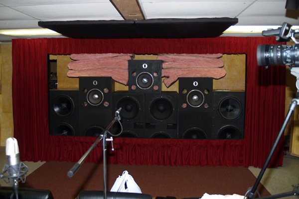

Here's why:
In the photo above, you can see the measuring mic position, about 9' from the drivers. This was taken during a retentioning of the movie screen, so the screen was temporarily removed during this shot. It gets stretched by being pushed in and out several inches from LF sound energy during loud playback of very low frequency events.
The woofers on the ends are very special. They can do nearly a 4" stroke and are linear to past 3". They have an upper cutoff around 60Hz. Their efficiency is best below 20Hz actually. They're probably contributing most to that curve.
This room has a real problem with bass. It just is a black hole for bass. Years ago, when I put conventional loudspeakers down here, they sounded, as my Italian friend used to say, like "paper cup speakers". It's impossible to get deep bass in this room. That is, until David Lee's little inventions arrived in 2006. Practically speaking, the system only needs one of those drivers. I bought four because I didn't believe the manufacter's claims and figured I'd need the extra output. Big mistake. Funny thing is, Room EQ Wizard measures pretty flat, except for a huge dip around 34Hz.
There is still a hint of problems with the ceiling and the concrete floor. Perhaps the carpeting is too thin. I could probably put down thicker carpet with a denser pile and padding on the carrying beam which is five 2x12 Black Locust timbers with 3/16" steel plates sandwitched in between the two innermost timbers. That sucker weighed almost 4,000lbs and I lifted it into place with an array of hydraulic jacks and stacking blocks over a week's time. It has a formidable bare surface area that is covered with luan mahogany.
I'm not completely done with the subwoofer design. The drivers are in cabinets I designed for a different driver 28 years ago. I've drawn up a new design for a pair of 38 cu ft cabinets with a vent area of 16 sq ft.
Some other things I plan to do is put foam or felt padding on the baffles of the mid/hf cabinets. That should clean up the response above 12KHz (which was not measured here) and eliminate the flutter echo between the screen and the baffle faces.
But as it stands, everyone who's heard music and fireworks on it has been truly delighted with the sound quality.
