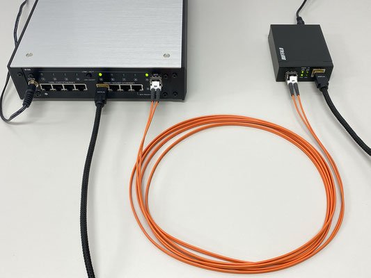

Dela/Melco of Japan announces an optinal optical conversion set for their S-100 audiophile switch.
It comprises an optical media converter, an optical fiber made by Corning and optical transievers :
Interestingly Dela/Melco has chosen multi-mode but not single-mode optical connection.
Here is the webpage :
https://www.dela-audio.com/product/op-s100/
The multi-mode choice does seem to conflict with the conventional wisdom (on this forum) that single mode sounds better. Interesting also, that Sonore also chose multi with it's optical modules.
