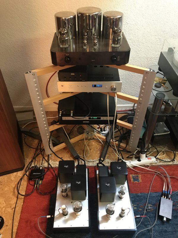

51B63E8D-542B-430F-BBB9-28219B86C23D.jpegThe little box on the floor left is the nano digi. Two DACs, a Metrum Octave mkii and Monarchy M24 are for the mid/bass and mid/high, respectively. The bass amp is the Ayon Spark and the mid/high horn is driven by the 300b monos (LD+ 91 monos).
