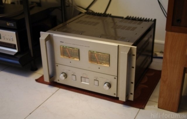

studio or stage amps do a great bass, i use yamaha amps wonderful natural bass superb punch and resolution.
best bass i ever heard is from the Yamaha M101 the home hifi version of the PC 5002m.
used around 12k€
Very nice.never seen this yamaha amplifier before.looks very professional.
140lbs pure iron,you need 25A mains at 220volt great sounding beast.
