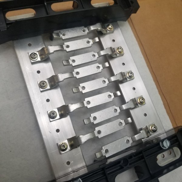

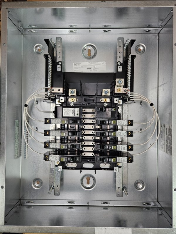

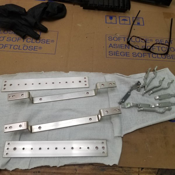

- regarding sub panel, I teetered between Eaton CH and Quad D’s QO line. I ultimately chose the former because it had a silver flashed bus bar vs. the latter which had a tin flashed bus bar. Silver is a better conductor but oxidizes more quickly. Not sure one is better from the other. I would have spec’d a sub panel custom built by Rex, but my time table did not allow that. Could be a potential upgrade in the future. Another option would have been a Quad D NQ panel but they require 20” stud bays of which I have “16. And I did not want to surface mount it.
