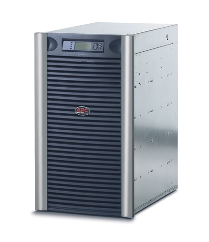

Has anyone considered the use of a data center class UPS for running the audio system? Just float the whole thing on battery and sidestep the grounding problem. This one is good for 16kVA @$15k
After hearing the Avantgarde amplifier on AC vs. its internal battery I was shocked by the very easy to hear differences. I am very sympathetic to battery-powered high-end devices. A battery-powered phono preamplifier and a battery-powered line stage make a lot of sense to me.
But, no, I had not thought about running the whole system on DC. Between my original horizontal grounding plan (which I implemented) and the David Karmeli alternative suggestion (which I also implemented) I would up spending far too much time, effort and money on grounding.
Running the whole system on DC sounds like an appealing choice. I do not know if there are any practical or theoretical disadvantages to using an UPS, however.
Kevin, the designer of living vox sets up his clients on battery power supply. His vox Olympians room in Munich is run off a battery pack
I guess we would have to focus on noise and RFI/EMI issues coming from the inverter?

None of the UPS systems I have will turn on without ground connection. I doubt this one is any different.
No doubt a ground is needed at the UPS but I was more referring to the gear floating on battery which should offer isolation from many of the issues normaly found without such a buffer. The unit is said to have less than 5% distortion at full load, I don't recall what the typical level of distortion is coming out of the wall receptacle but I'm guessing it's more than 5%.

This power supply thing would have been great to avoid spending a lot on dual grounding systems and balanced power but until it is tested in very high-end, low noise audio systems, and there is actual experience regarding any low-level noise and RFI/EMI issues coming from the inverter, I would be scared to roll the dice on it.
