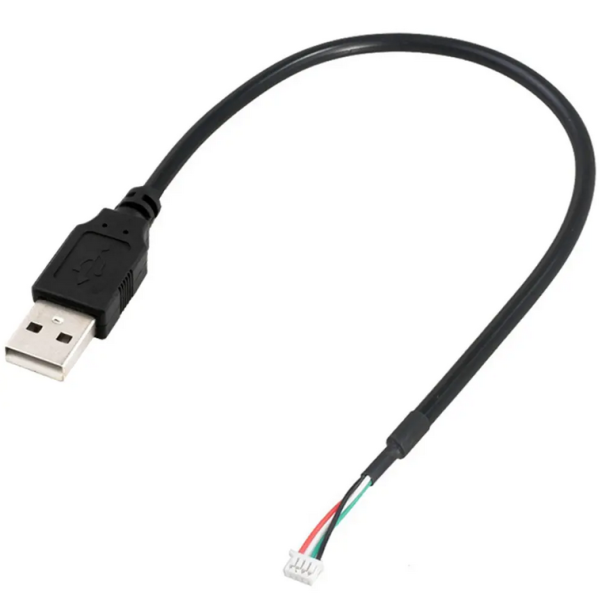

Just one last question, do you need a special cable to flash the firmware?

Glad you asked because I completely forgot. You'll need a USB A male to MX1.25 4-pin (if I'm not mistaking ... it's a small connector inside)
If unsure, they can provide you with one, I think I paid 10 euro for it but at least I got the right cable from the start.
The software to write the firmware is freeware: Atmel Flip ... it was throwing some errors when connecting at the beginning but then I found this clip:
And I remembered now, the 2nd SOtM switch was bought from the local dealer including the sCLK-EX board, BNC cable and connector installed ... BUT the firmware that was supposed to unlock external 10MHz clock input was not installed. So SOtM provided for free that file.
