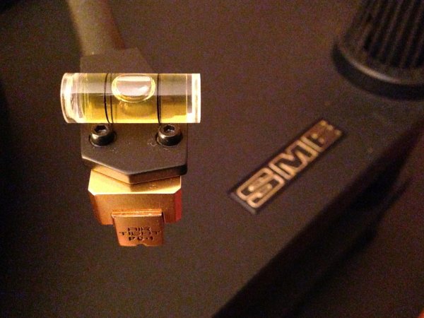

Everyone says that Azimuth is not adjustable on the fixed-headshell SME arms. Perhaps that is the case, BUT, when the arm post locking clamps are loose, you can slightly rotate the arm around its axis - azimuth - and then clamp the arm pillar in a slightly different orientation. I notice this because I adjust VTA/SRA for each LP, and this means that I am often locking and unlocking the arm post clamps to raise and lower the arm. I have learned that the arm post can be locked in slightly different vertical tilt orientations which surely is not good. So perhaps what I am doing is actually setting the post plum as opposed to slightly slanted before. My process involves a tiny bubble level, which I use on the headshell just behind the mounting screws for checking level. I realize that this does not guarantee that the stylus is square or plum in the groove, but it is a good quick reference, and it confirms what I hear when adjusting by ear. I noticed that the bubble level is slightly off, so I now rotate it 90 degrees and measure again, and then I take the average reading. I listened after using the level in this new way and heard an improvement. Well, this shows me that azimuth can matter, because this very tiny adjustment improved imaging solidity or focus, soundstaging, and channel balance/separation.

Here are three photographs showing the proximity of the counterweight to the gimbal pivot and the bubble level on the headshell for azimuth.
Great read Peter. I have forgotten to mention that my counter-weight is also at the closest to the pivot point it can be, to reduce inertia - there is just half a mm of travel left.

I have added a third photograph in my post above which shows my small bubble level resting on the SME headshell.

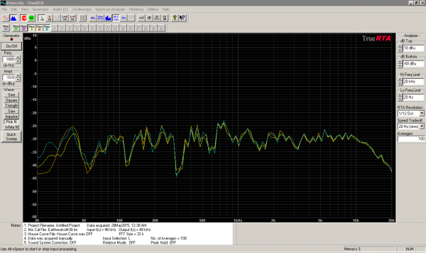

Thanks for the comments Calle-jr. You can see how substantial the room resonance is at 40 Hz. It seems slightly larger relative to the rest of the response in digital recording than in analog.
Here is a measurement of my room/system's frequency response taken at the listening seat while playing pink noise through from an LP. Both channels are summed. The different colors correspond to different cartridge loading settings.
And this is the same taken while playing pink noise through a digital file. This shows the left and right channels separately.
Mini_Digital_PsychoAcousticResponse_SeparateChannels_NoCorrection_RedLeft_GreenRight.png
