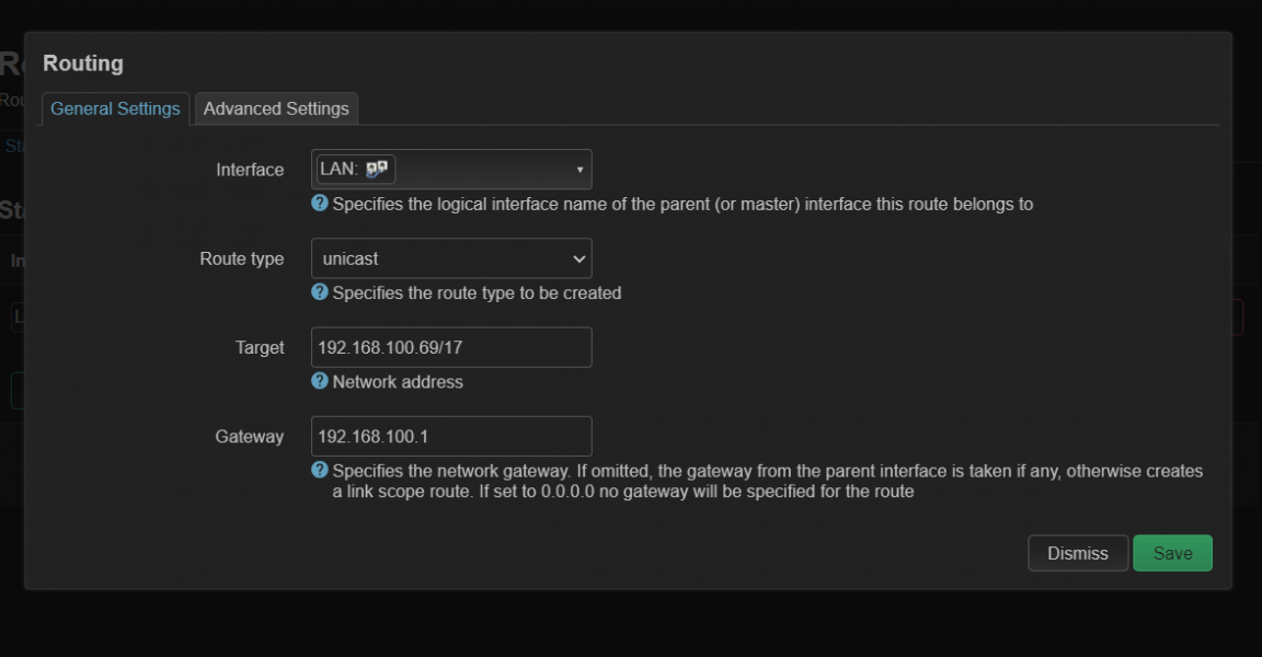

Port Forwarding with Taiko Router
I started working on this today since we don't yet have instructions from Taiko. I haven't gotten it figured out but I thought I would share what I have done in case someone can get me over the hump.
First, I started with the Taiko router to set up a rule to get to the Extreme. My Extreme's IP address is 192.168.100.69.
Here's what I entered on the network/routing screen:
I am a little confused as to what the target should be since I know it should be 192.168.100.69 but the syntax to open a port is not familiar to me. I think the /17 may mean port 17 but I really don't know. It won't allow you to enter a number greater than 99. It is possible that this should be /24 since that's what shows up on the Status/Routing page. So, this could be the issue with my setup.
My next step is to find the LAN address of the Taiko router on my main router. This is 192.168.1.180.
So, I set up a port forwarding rule on my main router to forward all "calls" to port 17 to 192.168.1.180.
Honestly, I am not 100% sure how to even check if this is working but any attempts to ping the Extreme from my main router came up empty.
Also, if I run Fing on my Taiko network I don't see port 17 being open so that may be another indication of it not being set up correctly.
Maybe someone can provide some help here.
Hi Dave
I also gave this a try, using different settings which I will not describe since it didn't work either.
After a bit of googling, I may(?) have identified the problem. From what I think I learned, the reason it fails is that it requires double forwarding. That is, the home router on 192.168.1.1 needs to port forward to the taiko router, hence you can't ping it or see it from the home network. Which ports need to be forwarded is also an unknown at my end.
While this may be doable (not sure I want to pursue this) it is certainly not plug and play even if it works.
As a non-expert here, I am guessing that the solution for plug and play would need to put the Taiko router on the same subnet as the home network, with settings and port forwarding to isolate the music playing traffic. No idea how to do that here.
I personally would be fine with a double forward solution and two separate subnets, which is probably also more secure, recognizing that this strategy does not scale well for emile et al.
I think I'm done messing with this for now and await guidance from those much more knowledgeable in networking theory and practice.
When someone knows all the ports that need to be forwarded from the home router to taiko router, I'll get back to messing around. I'm sure at least the vnc port 5900 has to be added.

Hi Dave
Hi Marty.
With 2 routers you have to set up 2 sets of forwarding rules but I am trying to do that. If you look at my example above, I am trying to forward anything using port 17 to 192.168.1.180 which is the Taiko router's IP address on the main router. I am then trying to forward anything using port 17 on the Taiko router to my Extreme.
How did you assign a port for forwarding on the Taiko router?
another thought.............should we forward to the lan or wan address; of the taiko router?
update: moving discussion to discord
Lan
