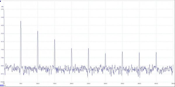

Now let's take a look at the spectrum analysis of a few linear power supplies in action:
Here you see harmonics becoming visible at 50Hz increments, 50Hz, 100Hz, 150Hz, 200Hz etc
An expanded scale up where you can see harmonics are quite visible up to 1KHz, expanding the view further you don't see much anymore.

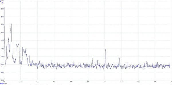

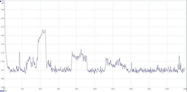

A SMPS:
Here you can see it switches at around 42KHz with spread spectrum applied which is quite common to flatten the peak in order to pass EMC testing. The harmonics at around 84KHz are pretty decent supressed.
A second SMPS:
This one has less well filtered harmonics, but the main switching frequency is a bit lower in magnitude.
If we expand it to a more broadband view we see some artefacts in the 500-700Khz range aswell:
Now what happens if we connect all of them to the same powerstrip?
We see an interaction going on, showing peaks, oscillations and resonances not visible in their individual spectra.

I would ignore the scale, I did not correct for scope sensitivity settings in the software. EDIT: Power supplies connecting to a Netgear GS108 switch (shows virtually no difference connected or not in HF expect slightly lower charging peaks), but only connected to 1 in the final measurement, it might show some difference due to the center taps of the ethernet isolation magnetics being high passed referenced to ground, but it is below the noise floor in this case.
This actually measuring ground, or rather safety earth, relative to another with an active (battery powered) differential probe. The SMPS noise is very likely dumped there by means of input filter Y caps, I don't have medical switchers here which omit Y caps so cannot really verify that.
