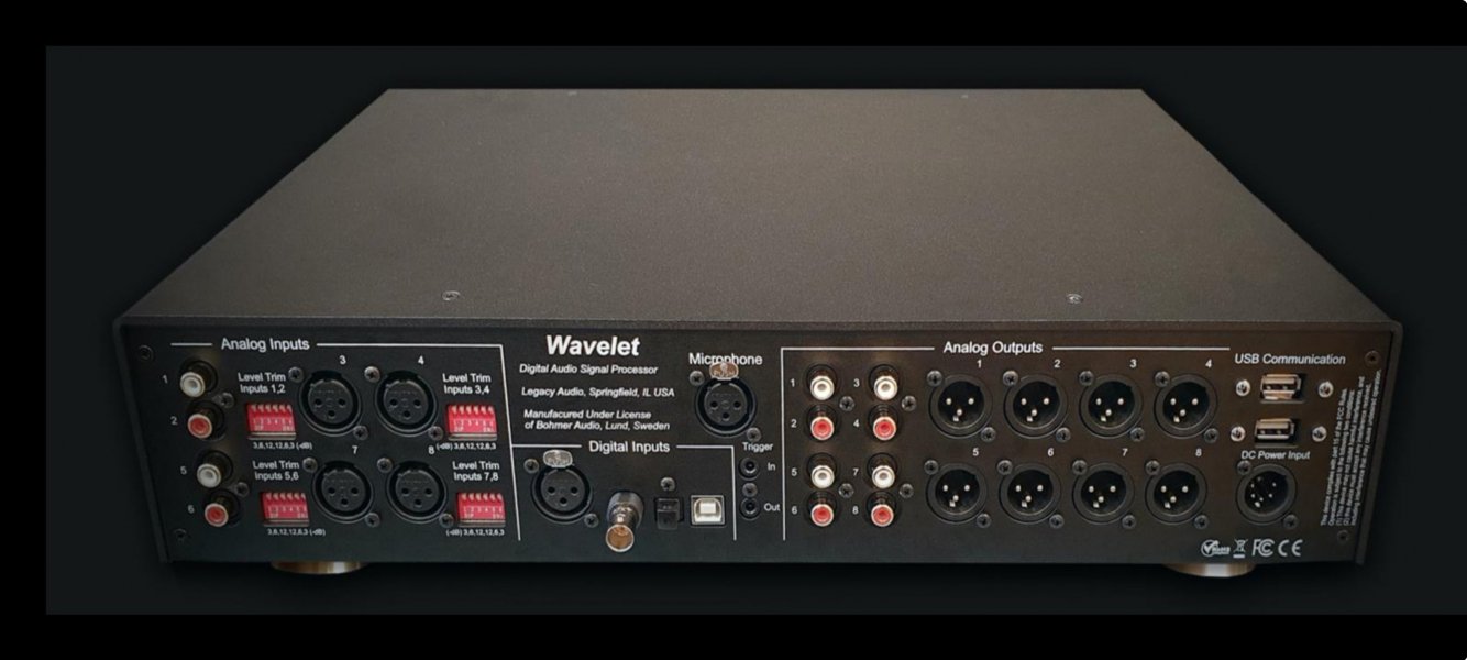

On Wavelet2, there are 3, not 2 USB inputs.
The two Type-A connectors above the XLR5 power input are interchangeable and used for system config.
The third, a Type-B connector is in the middle with the "Digital Inputs" group and where you would come in for streaming in via USB.

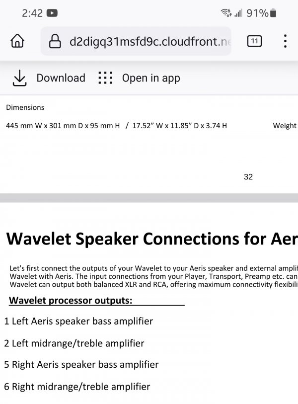

The last dwnloadable manual at the link earlier in this thread, shows this:

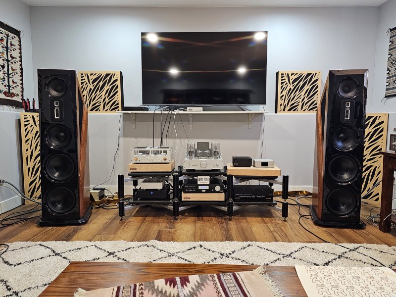

From the beginning, my wife and I played with speaker placement. We also moved the couch forward a bit. It's not so difficult moving these speakers around on my laminate flooring. We achieved a very solid central image while the 'sweet spot' was surprisingly generous. We will go through this exercise again on a tune night. (Yes, my wife and I have tune nights). Normal folks go to a restaurant, maybe a movie, we have tune nights. And with the factory setting, we were greeted with a generous soundstage width. It was after the room correction was applied, that my wife felt it lost some of its life. So I made some on the fly adjustments and at the end of the evening, my wife, my son and my cat were all seated on the couch, scrunched together enjoying a new copy of a fairly recent Robin Trower album (vinyl).
I have to tell you, with the lights off, while Robin's guitar oozed melody after melody, I wanted to grab a bottle of bourbon and a cigar and just drift off. Only problem was that the cat and my boy had me captured on the couch, and, I don't smoke cigars nor do I drink bourbon. But what flowed from those Aeris speakers took me to that place.
I swear there was smoke in the room.
