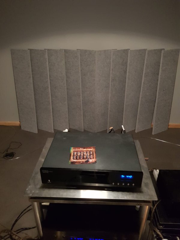

Fascinating to pick up on the marked improvement in imaging and bass articulation as a result of these acoustic treatments. So much fun to hear into mixes, get better separation, revealing of hidden motifs, and more effusive and musical basslines.
I've always struggled a bit w Kate Bush "This Woman's Work" rarities CDs, seemingly plagued w 80s style panned and harsh mastering.
Ok, not transformed into ECM-style audiophile fare (and neither should it, w all those gated snares and Fairlight synths), but suddenly the production choices are making way more sense and way more intelligible.
Really intrigued that room treatments can be so dramatic and so positive.
Interesting use of the panels, unlike the recommended 90 dg layout you have them at about 30. You could also have some fun on the front wall with the stepped block panels or some sculpted hexagonal units.

Blue .. it is amazing how much of this is now available in various commercial systems (usually at a premium price)... in the beggining they just stuck them on the walls where they have only a minor effect but used as a baffle system they are super effective as they reduce the sideways reflections off walls and ceilings.
The "eco" approach of removing the dreaded acoustic tile ceiling in commercial spaces and exposing concrete soffits and hence echo chambers had to be adressed
In Marcs case the angle ( actually 45 degrees when a simple fixing method is sorted ) is based on the minimum number of panels to partly absorb then reflect both first and second wall reflections away from listening spot . 90 degrees did not work as well. Very nice to hear the practice follows the theory.. but you cant discount constructers bias

Barry and Phil...I have them atm more like 30°...the great thing about my tentative setup is I can turn them easily to 45° in less than 5 mins.
Will try that soon.

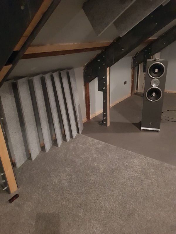

A few days in with the new PETs install on front and side walls to augment those on my eaves.

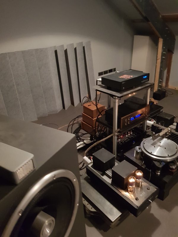

And now my two phases of PETs install, phase one being on my 30° descending eaves, phase two being on front and side walls, has provided benefits way beyond expectations.
I'm getting imaging that I really didn't believe the Zus were capable of, and a way more linear bass, more articulation and extension. I'm hearing into mixes, but full taking in of music on a holistic level, the sense of flow and ease is in a whole new place.
Phase three soon to happen, I've just ordered 1.2 cubic meter of sheeps wool to make up my 2 no. custom PETs-faced 1200x600x600 corner bass traps.
On the evidence that treatments have already wrought on the bass in this room, I have zero doubt these will be dramatic.

Fascinatingly, simple replacement of wall panels has led to a different balance of bass in my room, my intended bespoke bass traps have the potential to be very pivotal.
Yes, if you take out a lot of high frequency energy from the room , the bass will be more dominating. Don't forget that you have dialed in your subs for a different room response. You should measure your room before building bass absorbers, i am sure Bill could lend you proper equipment. :)
Higher frequencies seem fine. I actually think I've moved more to diffusion with somewhat less absorption. Somewhat less bass attenuation.
