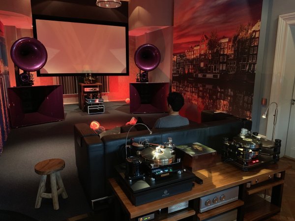

I visited audioquattr last week and, after I swore to him that I would not say a word about this amazing new system, I had to have Tinka put duct tape over my mouth because I have been bursting at the seams wanting to tell people what I heard from this system.
From the one-of-a-kind Cessaro Zeta system we all heard in Munich this year, to the Alieno amp (which I heard at Jeroen’s over a year ago), to the Grado Epoch on the absurdly complicated looking but amazing sounding Reed 5T on a brand new TechDAS AF3 Premium sitting on a Stacore platform, to the lengthened dedicated listening room, to the in-the-wall giant subwoofer drivers this is, to my ears, one of the two or three best systems I have ever heard in my life. (Jeroen also has the world’s first client copy of the brand new Alieno line stage preamplifier.)
Now that Jeroen has posted a photo of his stunning system on the AF3 thread I can finally spill the beans. This is such a unique system, with multiple presently one-of-a-kind components, I told Jeroen that, like MikeL’s system, among the systems I have heard personally, I think this is a system of real significance in the world of high-end audio.
After I visited Jeroen I did not write a coherent, comprehensive visit report like I normally do. So my observations on this thread are going to be more stream of consciousness rather than my usual coherence.
I did not even take any photos while I was there because I almost did not trust myself not to post them. I did take a cool video, but I do not know how to upload it here. Update a photo here:

I was wondering the same thing. It looks like all arms have been moved onto the AF3.

Congratulations Audioquattr! This rooms looks simply amazing. The lighting and camera angles of those photographs are superb. I feel the mood and would love to hear this system. I also really like the equipment rack behind the listening sofa. What a great looking room and system set up.
What speakers did these replace and how do they sound different? I presume the amps were used for both sets of speakers? I love the idea of the inwall woofers.
Thank you Peter, i have put a lot of work in this room the last few years.
The last 2 years i had the Magico M3.
Well this is completely other level on all characteristics. The overall tone is more beautifull from low to the highest highs.
Everything is even more precise and much more detailed. The speed and dynamics is the biggest difference.
Also soundstage is wider and more depht, you can walk through the soundstage. There is now a clear soundstage everywhere on the cough and behind. Not only at the sweetspot as with the M3 in my room.

I could not detect any weaknesses. I would give it a 10 on each of the usual audiophile characteristics. I found image sizes to be realistic. In this 31’ long room the speakers were pulled well into the room so there was plenty of depth.
I told audioquattr that if my system sounds 3/4 as good as his I will be ecstatic.
