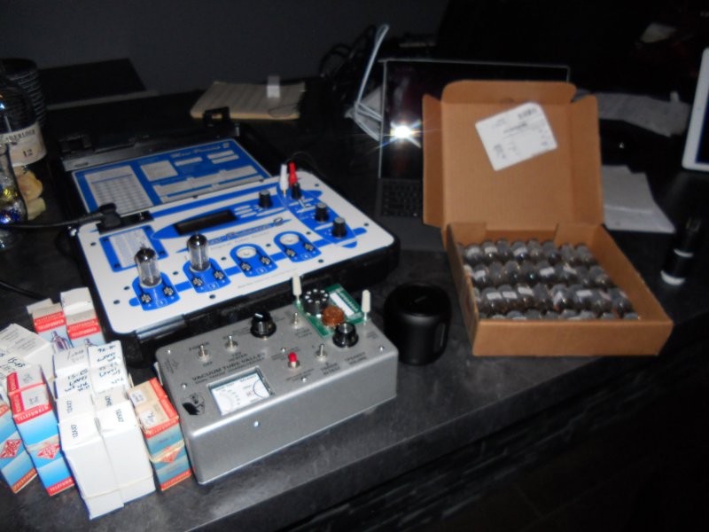

Dear Audioquest... please don't bestow upon me that kind of power to affect your tubes through thousands of miles!
I traditionally test my own tubes and have added a Maxi Pre II. I use a bluetooth speaker with 3.5mm out from the RCAs to listen for noise. This along with the VTV analyzer zeroes in for noise , gain and transconductance. All very relatable to the Amplitrex I have on loan. I sort through 50- 60 tubes at at time to get where I want to go.
For off the shelf ... I still maintain the Sovtek LPS is going to be your quietest for the longest time. JJ are nice but I personally, have not had good luck. Perhaps that has changed or I had a bad batch. Heat should not have any effect on your Io if it s situated well ventilated and your tube sockets are clean and tight. I will say that I have never had noise issues with my Io after going through this procedure in the many years I have had the unit. It does take time and you have to have the constitution for it.
Good luck on sorting things out.

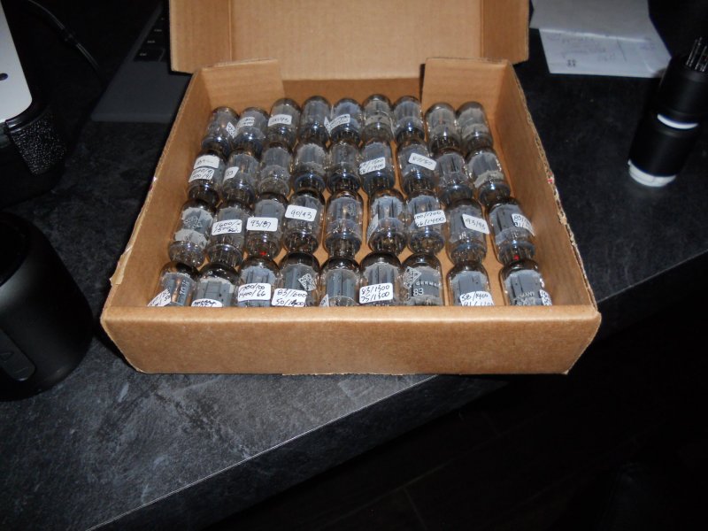

Thank you. I like how you stored your tubes in flat boxes with the measured readings on labels. Are the labels the regular Avery or generic Label?
When I ordered the MaxiPre a pop up appeared stating the Pre is delayed by 10 days
I am quite sure with their last run they only filled backorders... my MP was part of that last shipment. I must of waited about 6 weeks even though the website and phone call I got suggested much less. They only bring in enough parts for a run.. maybe 10-20 at a time ? I'm guessing --and then they re order major parts. Communication was good along the way. You just may have to wait 6wks or so if they don't have the major parts... transformers.. cases etc.
The labels are a small avery type. I usually enter them in a spread sheet and figured out how to print them - but sometimes you get lazy :)
