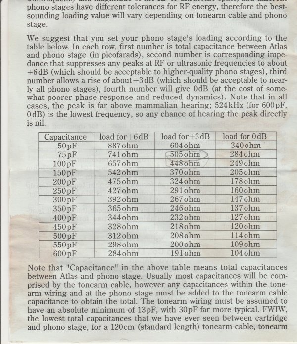

Hi sonorlite - With the Io, getting to know how this phono stage works, I would not worry too much about the cartridge loading. It sounds fairly good anyway, at least from my own testing, using Lyra carts like the Titan and the Atlas. Since my Io is placed in a rack with the back towards the wall (in a combined listening / living room), changing loading is not so easy, and I don't do much A/B testing. I have generally settled on what the cart manufacturer suggests, like 4-500 ohm for the Lyra Atlas, but I have also noticed, some things sound real nice with a lower load, others with a higher load - the changes are not dramatic. Other types of cartridges may be more sensitive. But, if I was new to the Io, I would first try to adjust the cart and player as well as possible, for best sound, just settling for a compromise regarding the loading. And then, fine tune the loading. - Others may have better procedures.
Lyra includes a table on how to calculate the loading based on the total circuit (cable plus cart) which seems to work fairly well. Nevertheless, if I clearly heard my cartridge sounding better at 10 khz, I would do the further adjustments from there. Or at least, try that way. Adjustments: first double check that all is optimal regarding the cartridge, weight, azimuth, vertical tracking angle, overhang, player is dead level, and so on. Next, fix the electricity. Obviously this procedure may lead wrong. If you have a cartridge suggested for like 500 ohm, something else is maybe wrong in the system if it sounds best at 10k ohm? Yet, I guess it may happen, even when all is well regarding the cartrige and player adjustment, and in that case, I would go from there.
From the Lyra Atlas manual:
My tonearm cable Kimber KCAG has 51 pf / meter. I add 30 for my stock SME V internal tonearm wiring. Going on from there, I have found a fairly good compromise - ears and calculations agreeing. Good advice from Lyra - should work for most MC cartridges, or at least, some values to try, with the Io.
