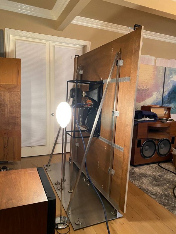

Here is some pics. They have been sound tested. Very much look and sound like ddk's big gun.
The black box is a JBL sub. Originally we planed to use B460 17"-18" ones like David's but my room is quite smaller than his so we opt for B380 15" pair instead. The crossover is also the same as what David is using. I have the picture of the opened box but it is proprietary so will not post pic.
The frame and the footing is made of stainless steel. Nothing quite like it in vintage speakers. The idea is shoot for the best sound using a combination of vintage and modern components. One would be mistaken thinking that David is a vintage guy. I think he is the natural sound guy who picks component that sound natural regardless of time made. It just so happened that some components having that natural sound were made in 1957. The Lamm to me is modern. AS2000 is modern. Denon speaker cables were made in the 80's no vintage by my standard.
on both sides of baffle you will see wood strips. I thought they were there for making subtle dimensional cosmetic. But talking to David, those strips effect sound. In fact the whole baffle is so important since it effect sound. I could change the baffle width from 180cm to 200cm to change the sound too. So the speaker is tunable for specific room.
Now I am waiting for David to stain the baffle. Then they will be shipped together with subs and the ML2s. I have been waiting for this speakers since the Baht was 30/$ now 36.5/$ hahaha. It is the friendship we have that makes David took great length to do this for me. A treasure passing on to a friend.

In what way do the wooden end strips affect the sound?

Short answer, the additional width smooths out mid and upper frequencies. With this type of design you have both electronic and mechanical crossover, ie the horn and the baffle. Klangfilm‘s design is for 2m x 2m but due to space constraints we made them 1.80m x 2m so I added the slide out wings in case he has more room, it makes a difference even if they’re not fully extended. Staggering them is an aesthetic element, easier to make them flat but having wings hang out flush from the sides without the base section looked like an after thought.
