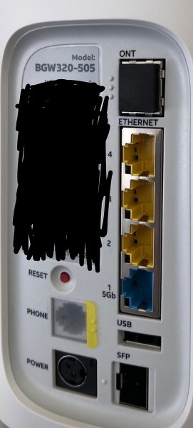

Att is coming out with a new Gateway, the BGW320-505. It has an integrated ONT. I'm guessing your mod would be more difficult or impossible on the 320?
