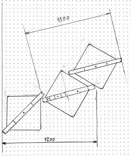

@LL21 I have asked Daniele Coen for clarification on alternative setup options for a multi panel system. He send me the following drawing just now. The crossovers can actually be configured for this type of placement by default, which is something I was not aware of, they can be configured to adjust for a wide array of placements. There are multiple outputs on each crossover and it's simply a matter of plugging the cables interfacing between panels to crossovers into different connectors. I personally like the 1 meter wide placement option most from a visual POV, will try that when ours arrive.

Thank you! That is SUPER-efficient use of space! Very very interesting.
Does the BACK panel behind have to be 1.2M from the front wall? Or is it ok if the FRONT panel is 1.2M from the front wall?
1.2M is really the minimum clearance for both panels. So the front of each speaker panel needs to be 1.25 from the wall behind it.
Got it. Thank you. The corners are 1.5m and curved since it is a historic house. So trying to think about how to get it right without intruding into the space too much. The front of the Wilsons are 1.2M from part of front wall but not all of it, and they are only 16 inches wide.
