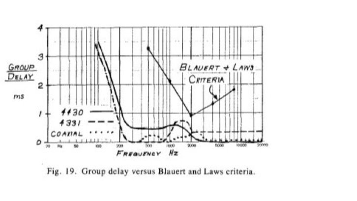

This shows the audibility of Group Delay if that's what you are asking?
Rob :)
Rob :)
No - I am talking about that that we hear a slap echo as different from the direct sound, when it is some milliseconds delayed.
Too close in time, then we cannot hear it as separate.
1) Actual resolution is independent from tonal balance.
