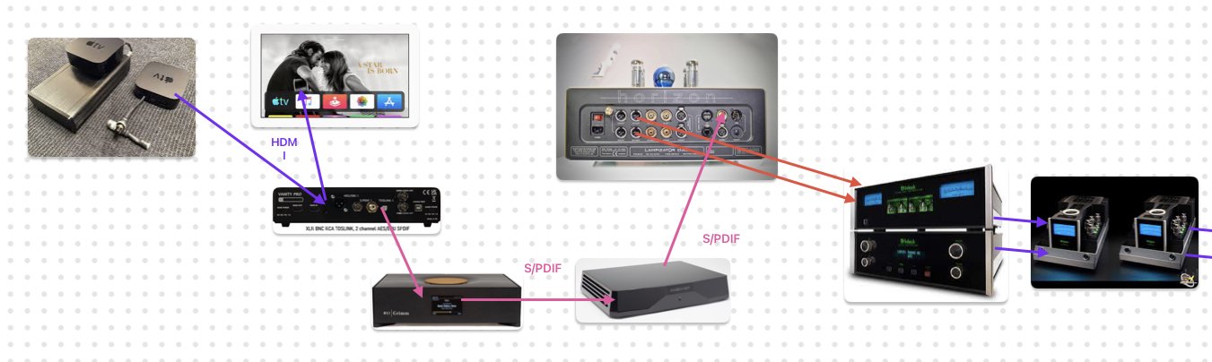

Here what im thinking for the BACCH / grimm mu1 setup. Should also provide upsampled youtube concert content on the big screen. Im hoping the apple tv has enough delay perimeter to lip sync the setup.

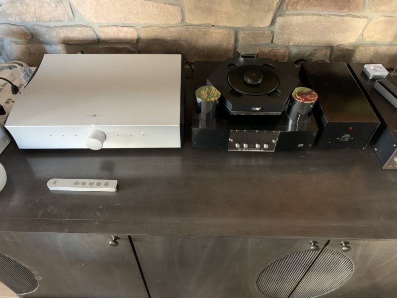

I have recently acquired the Mola Mola Makua preamp, fully loaded with the phono stage — which is amazing — and the DAC that’s the same as the Tambaqui (perhaps better according to the designer Brian Putzeys as it does away with the Tambaqui’s digital volume control in favor of a no holds barred discrete class A gain stage). But I’m feeding Roon direct through the LAN input through a Roon Intel NUC server remotely located in a closet in a different area of my house. Works really well.
So the question is: why bother getting the Grimm MU-1? One problem with the MU-1 is that native DSD is not passed directly to the Makua. Once you use its upsampler, then you need to use the AES-EBU output, which means PCM conversion. Not sure it’s worth the trade off, particularly given the asking price. I’m in general wary of these additional processors that are introducing their own colorations.
Here’s my setup. I use the Mola Mola Kaluga class D amps that are terrific as well. It’s in my second system. My primary system is all tube — single ended triode and horn based. But the Mola Mola is great for casual listening when I don’t feel like turning on the 25+ tubes in my primary system!

I also use as my primary digital source the incomparable CEC TL0 belt driven two box CD transport. I have yet to hear a streamer that can touch its gripping and hugely dynamic sound.

Very cool and nice system. IDC much about DSD though my Tambaqui has no problem supporting DSD feeding my Krell preamplifier. The big question for me is if this Makua preamplifier is going to deliver over 10K worth of SQ gain versus what I presently have in the Krell Illusion II. AND BTW, forgot to mention hat Bil Parrish who is the USA distributor for Mola Mola says that on should absolutely use a music streamer for optimal results with respect to the Tambaqui. I too have it Hooke up to my network via ethernet but Bill states the Tambaqui sounds better when deployed with a good music streamer. Cheers ...

I think the Mola Mola DAC also converts everything to PCM for conversion to Analog.

No, it does not. It converts all digital signals to a high bandwidth pulse width modulated signal. As per their website. PWM is not PCM!
“Mola Mola's Tambaqui DAC is the perfect upgrade for owners of complete high-end systems who want to retain the characteristic sound of their existing preamplifier whilst lifting their digital sources to another level. The converter is a two board stack. On the first board, all incoming digital audio is upsampled to 3.125MHz/32 bits and converted to noise shaped PWM. On the other board are two mono DACs, in which a discrete 32- stage FIR DAC and a single-stage 4th order filtering I/V converter, convert the PWM into analogue with a breathtaking 130dB SNR. This is near the theoretical limit for 24-bit files and far beyond that of even quad-speed DSD. Uniquely, distortion remains below the noise floor even for full scale signals.”
