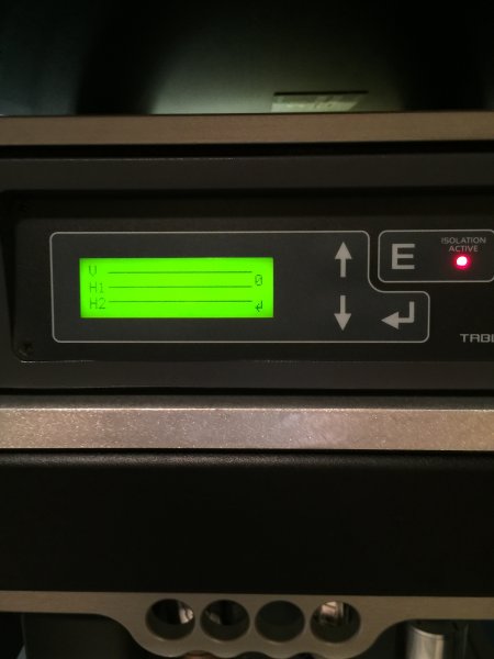

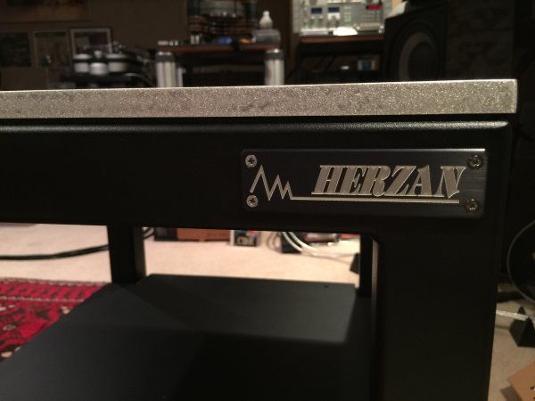

My custom TT stand made by Herzan arrived today on a freight shipping pallet. It weighs roughly 150lbs and is made from welded 2" steel box tubing. It has a thick damping plate on top (1/2" plate) and damping plates...thinner 1/8" on the lower component shelves. It is amazing how well constructed it is. The best part, my TS-140 functions properly due to the stand's horizontal rigidity.
Cost ? Let's just say stereo stand makers cannot compete. It is a bargain. I will not disclose pricing as everyone's needs are different and Herzan would be happy to design to your spec and provide a quote. My stand cost me less than $2000.00.
