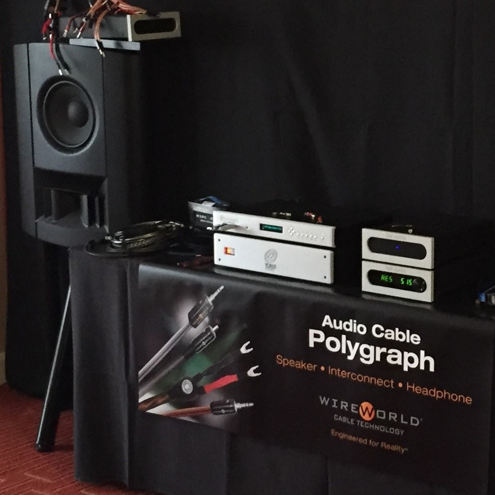

I've spoken extensively to David Salz of Wireworld (great guy by the way), who started his company by placing components back to back and fusing the output connectors of a source directly to the input connectors of the preamp eliminating any cabling.
He used that as his benchmark and built cables that came the closest to reproducing the result. I can't think of a better design philosophy than that. I really like his cables too. :)
