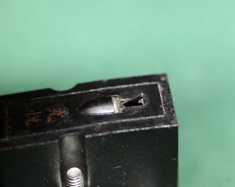

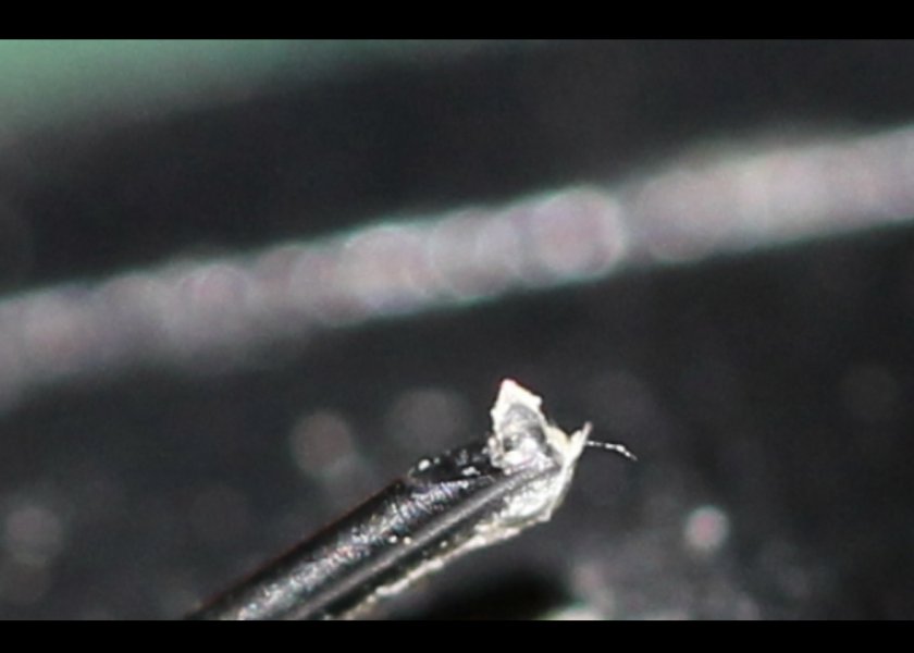

Took the whole arm off to try and get pics with my Canon. IDK, stylus looks ok? When I reinstalled I realized that I may have not had the arm directly centered on the pivot point from the other day when I was experimenting with an added weight to the VPI counterweight from a Soundsmith Counter Intuitive I’d gotten. After the pictures were taken I re installed the arm and checked all the parameters and now it sings again. No more barking at the upper extremes.
View attachment 112648View attachment 112649
You cannot tell ANYTHING about stylus wear from this level of magnification & resolution, or even a few times more. If the stylus were fractured you could see that, but it's far more likely to go completely missing. If it's filthy, you can see that too (yours is clean - nice!). Without specialized equipment and experience (to know what to look for), your EARS are by far the best tool at your disposal! And yes, it's always good to periodically re-check alignment & setup parameters. If you hear mis-tracking, I would check alignment, VTF (going a bit higher sometimes helps) and anti-skate (don't use too much!). If you need to sanity check, a Koetsu should track well at 2.2g (a bit higher than spec) and 0 anti-skate -- if it doesn't then something is wrong.
I'm glad you were able to find improvement! Enjoy your beautiful Koetsu now.
