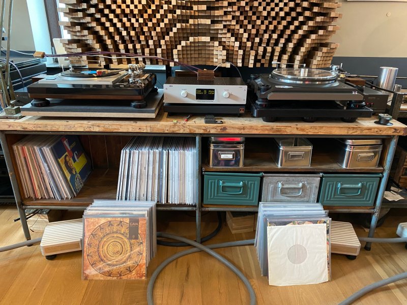

my direct drive journey continues :)
A Technics SL 1000 MKII has arrived.
I will report in a new thread, when I have installed the turntable properly.
