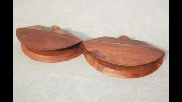

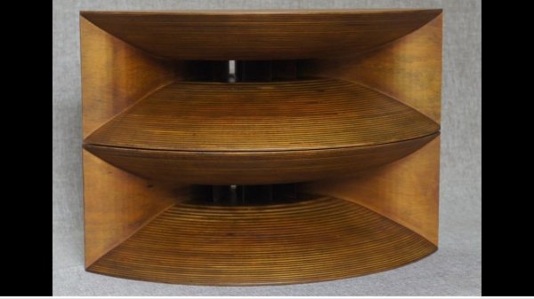

IMG_0791.jpgI have decided to make the 3415's into something different. I like the sound of the TAD type speakers so I can use a Rey Audio RH3 horn for the mid range which measure 27"W and 10"H. Whether I can use the adjustable pedestal or not for mounting remains to be seen. The pedestal is removeable. With both horns mounted without, my guess total height would be just under 6 feet. With that height the speaker locations are a lot more flexible in the room and I think it will fill my dual purpose of a HT and Stereo system better. Another plus is both these Westlake and Rey Audio horns were made for the TAD TD 4001 drivers.
Both HF and Mid horns pictured.

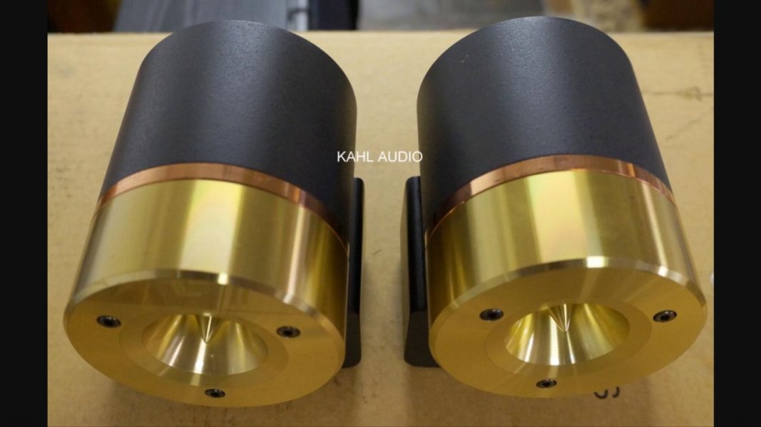

Are these Fostex's beautiful or what...

I'm currently using them, they are excellent tweeters.
Hi Dave, You are using them in a 3 way or 4 way config?
3-way... I use a 330 Hz Le Cleac'h w/ a 4.5" driver to cover 400-15,000 Hz. Tweeter has .57 uF capacitance on it for both xo and attenuation.
It's a very neutral sounding tweeter that blends seamlessly with the mids and adds a lot to the sound. Lower end Fostex has noticeable metallic sounding resonances that keep it from blending well. T500A MkII isn't cheap but it's well worth it.
