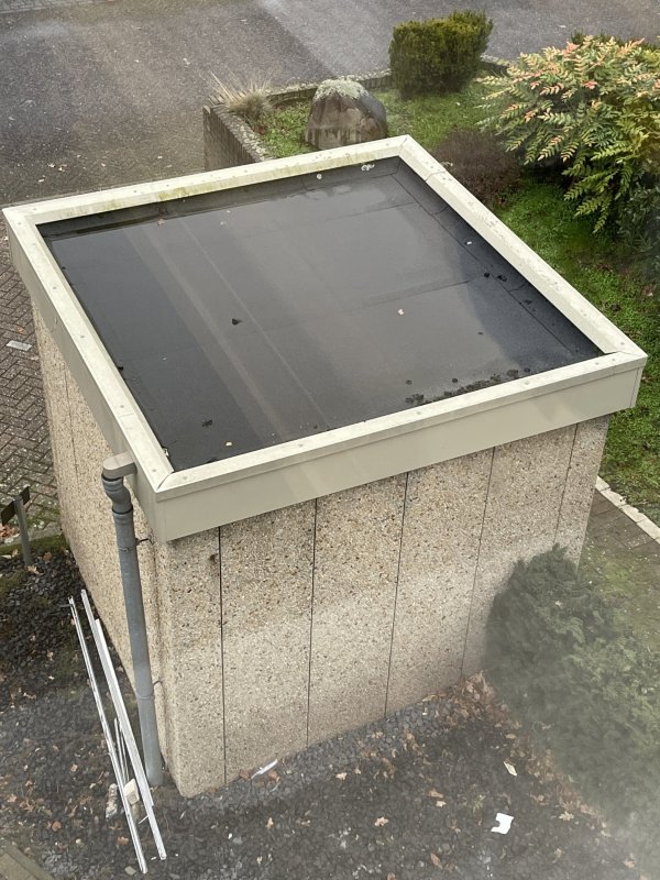

The problem is the complexity makes behaviour very unpredictable, and I’m sorry to say unsolvable. Even this dedicated utility transformer home right in front of our building doesn’t solve this, photo taken from my
office just now, there is about 14 meters of power-cabling between the system and the mains utility transformer.
The only real solution for the powergrid “problem” I found was running off batteries.

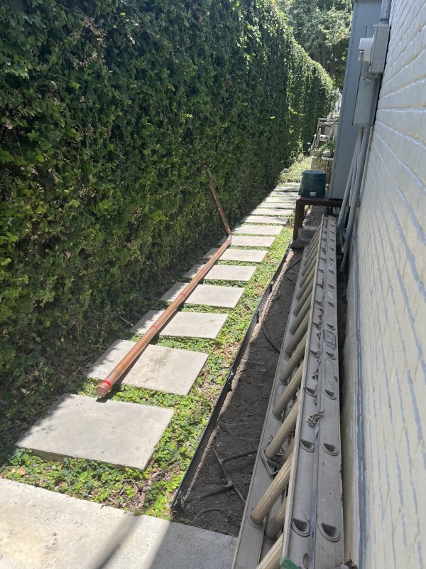

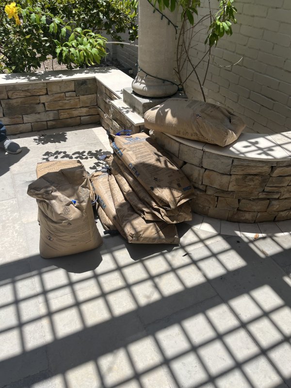

FWIW, on the recommendation of Stirling Trayle, we used an enhanced grounding “L Shaped”’ rod about 8’ long and 2’ high buried into a trench covered with an enhanced grounding cement that got the resistance down to 0.2 ohms. It made a dramatic difference in the sound quality.

They couldn't have if they were driven into the ground. Even in peat which basically stays moist it would be difficult to achieve consistent 0.5 ohm. Grounding enhancement material is the best option. Erico Gem 25A is one product. The correct application is to auger the holes 6-8" diameter. Once you get the rod tapped into the ground after mixing it is poured around the rods. Don't go above the clamp because proper application requires bare 6awg to make the bridges for multiple rods. The 6awg should also be encased in the grounding material, typically 8-10 " deep and 10' apart. Depending on the substrate 8-10' ground rods. Rule of thumb 10' Ground Rod 10' apart.
FWIW, on the recommendation of Stirling Trayle, we used an enhanced grounding “L Shaped”’ rod about 8’ long and 2’ high buried into a trench covered with an enhanced grounding cement that got the impedance down to 0.2 ohms. It made a dramatic difference in the sound quality.
Horizontal placement works nicely especially with rocky terrain. A back hoe is easier to arrange than to auger all those holes.

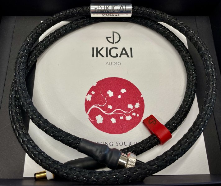

Since I hate that there are 2.1mm and 2.5mm Jack, such a small difference seems pretty stupid. In my case, the Jack of my Paul Hynes that powers my Melco S-100 switch is 2.1 mm, so I already have a little problem powering the Taiko Switch.
What measurement is 2.1mm? Is that the output of the Hynes? That doesn't matter for the Taiko switch. You just need a cable which works the Hynes LPs and is terminated with a 2.5mm on the other end.
Ghent Audio makes very nice cables that are not too expensive.
