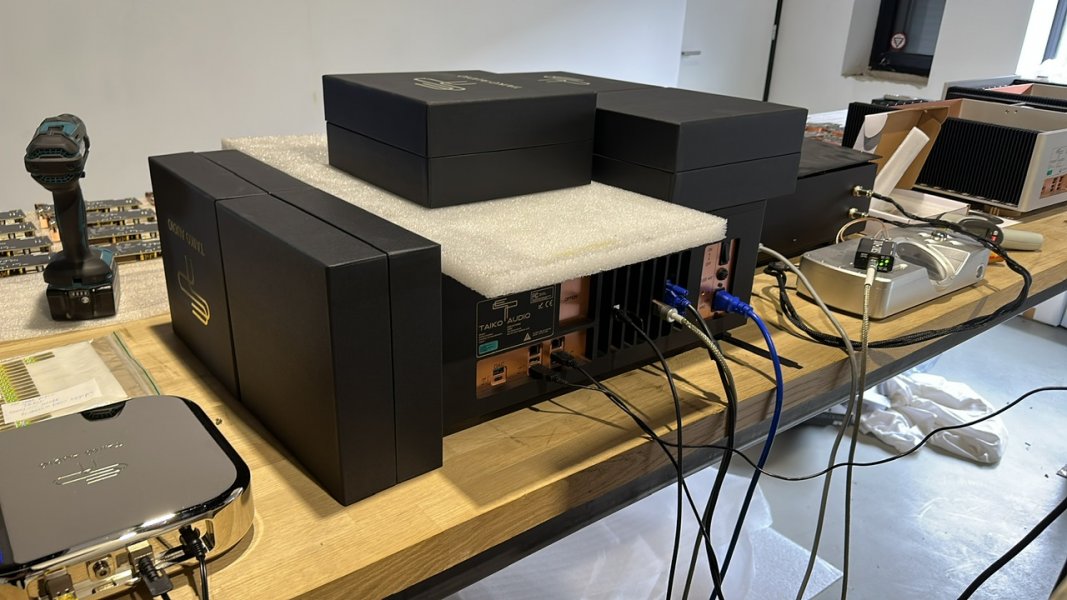

Your card runs slightly cooler without the bracket installed due to increased airflow. This is exactly what threw us off track initially but it’s not a mechanical issue. I actually have to obstruct airflow to reproduce it here due to a relatively low 19 Celcius ambient temperature.
I do not even get an initial connection.

Yes, over temperature protection is triggered WAY early. Running it with the bracket removed or without top cover can be temporary fixes till we figure out how to correct the firmware.

That doesn’t help. It really triggers substantially too early, like 35-40 Celcius, before it should. Leaving the top cover off, or no bracket, can make like a 5 degree difference, moving to a different slot makes no difference.
