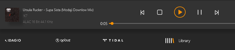

Where can you see if the files are WAV or FLAC files. I've never paid any attention other than if they were 44.1 or DSD files.
You can see this in the Mini Player (bottom bar) when the file is playing.
For instance, Apple Lossless below:
AIFF or WAV:
FLAC:
Will make a note to think about also adding this to the folder views:).

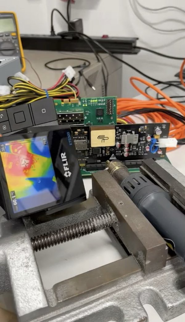

Pictured here in a sub-basement lab at Taiko, we look in on thermal testing prototypes believed capable of Extreme performance reaching DSD^7.
