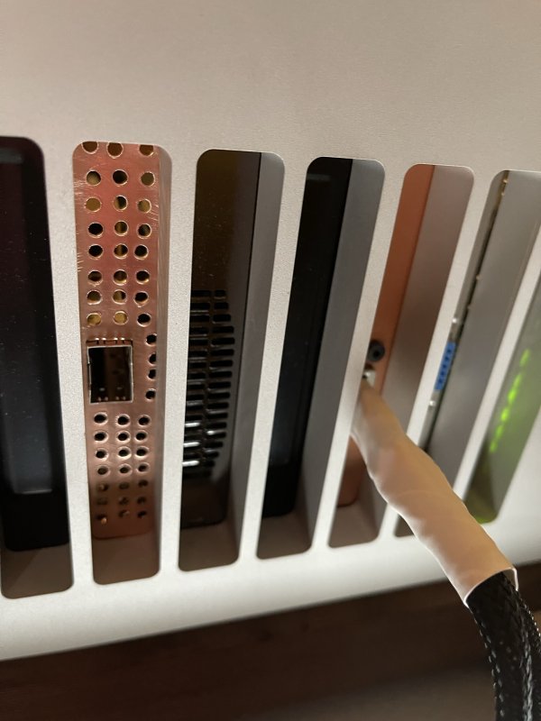

I went the Taiko method
On my drill press in the garage shop. I just eyeballed it. I hope this was the old throw away bracket or I would have measured.
The copper gets kind of bendy with all those holes.
Reactions: Taiko Audio
I think that was 7/64 on us scale. Drill bits are about the only thing I don't have in both us and metric.
Reactions: Zeotrope

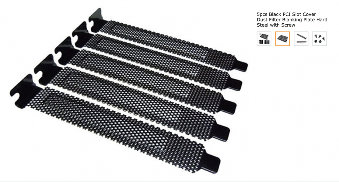

I while I definitely applaud the DIY efforts there does exist a wide range of expansion slot back covers already ventilated, for very inexpensive prices. These don't have the cutout for the SFP cage (though that can easily be added), but they would definitely replace the stock, non-ventilated expansion slot covers:
Screenshot 2023-03-23 at 3.38.50 PM.pngNo endorsement of Amazon intended, but this is typical of what is out there.

If you clamp a piece of wood or metal to the bracket while using the drill press (or even if you are using a hand drill) the holes will be truer without as much bend or give around the holes. It will keep it more rigid...
This is what I think I did - I used the 2 wood blocks the new bracket is shipped with. But with a hand drill punch you don’t need to.
Reactions: John T
If a piece is flush to one side it will just make a neater job. It sounds as though this is what you did. I would also use a cone shaped bit.
Reactions: Zeotrope

I made a ton of 3/32 holes, in addition to the larger holes I made yesterday. I’m embarrassed to show the photo, it certainly does not look like @RichardA ’s fine effort. It’s definitely function over form, but there are holes everywhere. Let’s see…
The Neiko 02612A Hand Held Power Punch, is easy to use and does a great job making perfect holes. It’s just not easy to line them up, if you care about that then mark the holes with a pen and ruler first.
