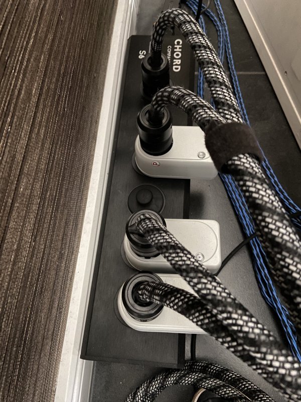

I use AUTH line filter EMX 506 and AUTH line filter EMD 503 with every SMPS in the chain:
Looks like this:
Torben
Reactions: Long Live Analog
