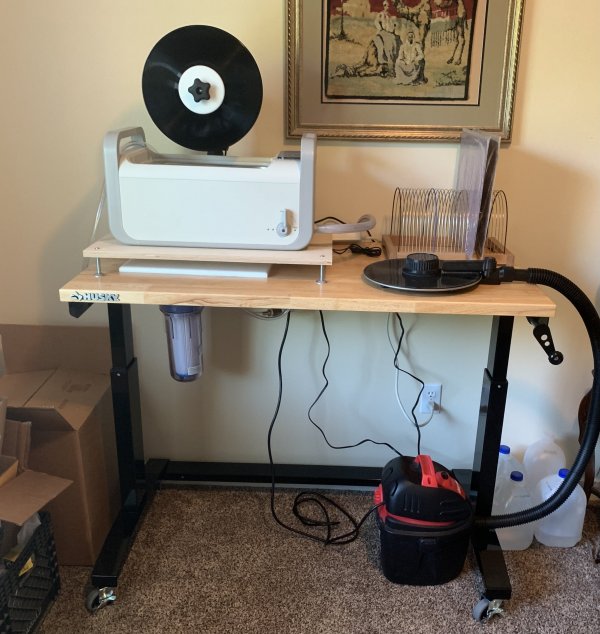

Well I got mine all setup today. New ultrasonic with a pump under the work table, and you can see the filter. Then rinse & vacuum large amounts of water and finish with an air dry. The rack was made by some guy in Europe, found on Etsy, it's pretty nice. I might clean up some cables and add a switch for the pump - maybe anchor the hose from vacuum somehow.
