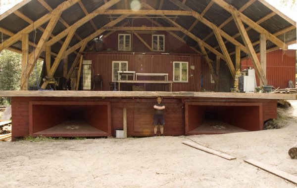

I definitely dream of one day building the ultimate system and room. I see what some of these crazy guys do with truly giant custom horn installations and they make me drool, but (like most of us) I've never had an opportunity to hear one of these crazy systems (see pics).
But I'm guessing at least a few of you have and others probably possess some theoretical engineering knowledge around the issues these giant horn systems might create, but I've never seen a thread that discusses the sonic pro's and con's of these systems.
Would love to hear some thoughts (even if it is just some pontificating on theory) regarding these types of installations. Let's discuss.

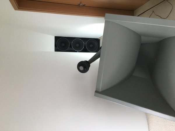

Basshorn worth my old Satos

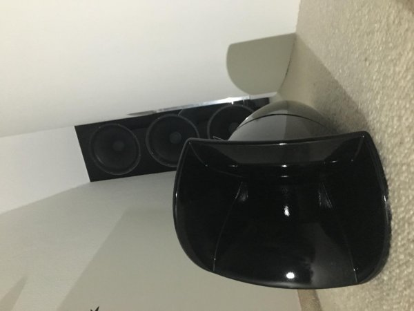

Basshorn with our Elysio HT16 Tweeterhorn
Now I'm just waiting for the WE66A ;)

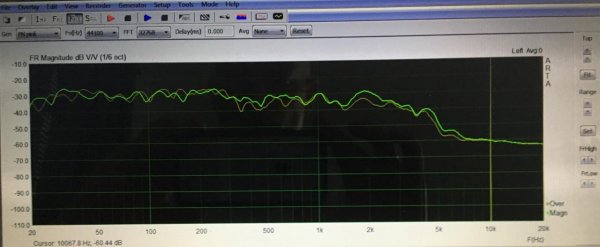

The first measurement of the basshorn. 380 cm distance to the hornmouth. So you see also the room. Important is 20-140Hz
Hello Karel, sadly the WE66A isn't ready right now. Will need some more days.
Best Regards Swen
attachment.php
That looks rather promising, of course everything looks smooth with a 100dB scale and 10dB/div. ;) You might get more useful info cutting both those numbers in 1/2.
So it s more like +- 5 db at what smooth factor?
IT runs also from 20 Hz to 2 kHz "reasonsbly " flat ,so you might be able to skip the mid altogether , what i dont understand is why they built such a large Basshorn then if a small one does it also.
Why does this measuring device gives still such a high output Above 10 kHz by the way?

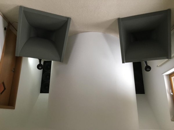

We've nearly copied the design from the legendary Tamaru System in Japan. But we changed the Midrange to implement our Horns
I'm very much interested in doing something similar to this design one day and have followed you guys for awhile. Could you elaborate on some of the challenges and "things to know" about building the ceiling mounted horns?
The ceiling horn is realy not easy to realize. The weigh of the one we've build was 12.000 kg.
You also need minimum 650 cm height.
If you like you can contact me at Facebook or mail.
Best Regards Swen
