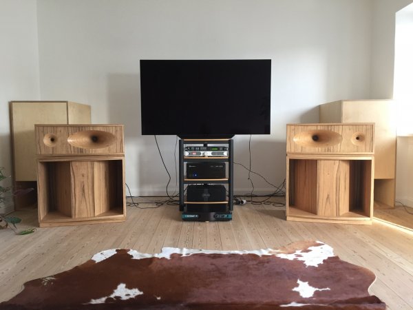

What drivers do you use in yours?
I use today's drivers.
Neodym 15" driver for the bass horn, a 7" midrange in the large white horn (120Hz-4KHz) and a 1" driver in the small round horn for the treble.
It is a quasi coaxial system.
Also some subwoofers, based on 8 15" drivers in infinite baffle and one 18" driver in a 2.5m tall tapped horn.
The crossover is passive and the 3-way coax horn is driven by a Totaldac Amp-1 amplifier.

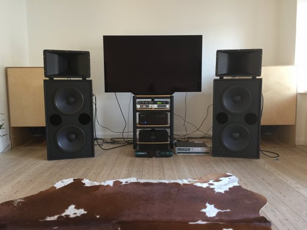

My current set-up. Will return with a rundown on the specific components used.
Blasphemous perhaps, but in a few days will swap out (periodically, as an outset, and not with the necessary intention of selling..) my all-horn Simon Mears Audio Uccello main speakers with a pair of horn-hybrid pro cinema speakers from Electro-Voice, the TS940D LX ('LX:' meant for active config.). They house twin DL15W bass drivers and the DH1A compression driver fitted to a 90x40 coverage constant directivity horn, the HP940:
(partially incorrect data sheet)
https://www.electrovoice.com/binary/TS940D_Engineering_Data_Sheet.PDF

I'm just a casual observer in this thread, but if ur a dynamic driver kinda guy - how do you explain that Magicos top speaker is horn loaded - everything else infinite baffled boxes?...
As an equally casual observer, i do think there is real merit in these SOTA horns...the challenge (for me anyway) is that these SOTA horns seem so HUGE. I have never truly investigated, but the ones I read about...Western Electric, Biohorns, Vox Olympian (which really requires the matching sub otherwise i think you are paying 300K for a speaker that goes down to 70hz or something), the Magico Ultimate, Aries Cerat Symphonia, not to mention the big Cessaro Beethoven or others...
...i think cones are very space-efficient. And there are clearly those who would take horns over cones for reasons of their appreciation of horn qualities (which i respect). However, for me the choice of wanting scale, power, deep subterranean bass...as well as mids, highs, etc...means that to get that in horn-world is a commitment of square footage I am not prepared to make. Whereas there are a number of amazing cone speakers (for me) that have a footprint of less than 1.5 feet by 2+ feet (Wilson XVX) or even 2 feet by 3 feet (Arrakis) that present gargantuan scale, effortlessness, detail, etc, etc.
