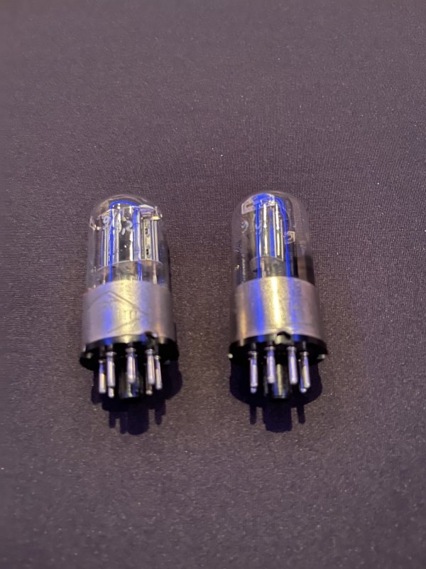

The Melz metal plates I've seen either have vertical rectangle holes or round holes. Are there some with "no holes"?
Yes. And according to Lukasz those without are the best. Mine have no holes on the plates

I'd say if the "no holes" are metal base from the 50s, and if the application is to use them as a preamp tube and not as a driver, maybe the two may be regarded as roughly equal in the sense that depending on the vintage, one will find a better pair of one versus the other. In general, however, the 1578 with holes are more expensive for a reason. Be sure not to pay more for a 6H8C (Cyrillic for 6N8S) without holes than with holes in the plate (see pic below, please note it is NOT mine and that I'm not in the tube-selling business), the price ratio should still be around 50% for the non-hole metal base 6H8C compared to the famed "Holy Plate", and that bakelite base non-holes are dirt-cheap for good reason. Apparently the change was made for good reason, by the way, which wasn't sound quality, of course, but heat dissipation. Hence what I said in the beginning, it may depend on the application. A DAC isn't the same as an amplifier.
Having said all this, I'd like to add something prospective buyers of either might want to know: don't panic if you happen to have a noisy one! That may be due to the old solder having crystallized in one or several pins. Sometimes reheating alone will solve the problem, if not, re-soldering (heating one by one with a soldering iron adding a needle pin's worth of fresh solder, then brushing the pins clean with a soft metal brush), if that won't do, use a solder pump and replace the old solder altogether. Needless to say, there are audiophiles who swear replacing the old with silver solder will improve the sound.

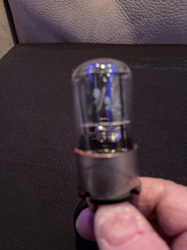

when we inserted the MELZ Metal Plate, Lukasz discussed this very thing with all of the attendees. He said many times you hade tap the tube the noise would stop. Lukasz also discussed that there is indeed one pin that needs a small amount of solder to solve the problem. Having said that the issue of one hole vs 5 holes was discussed and Lukasz did comment that the MELZ tubes he seeks out as he prefers them the most are the ones with NO holes. He was quite insistent that the ones with no holes are sonically superior and sound more organic than the same tubes with perforated plates

Steve, I think your phone's focus needs a little realignment;)
No it was me trying to taks some fast pictures with everyone hovering around. Ill get better ones later. Everyone is still sleeping
