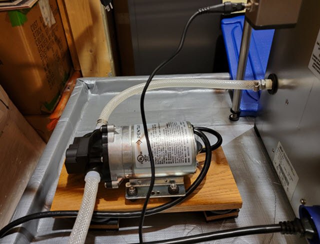

Here are the hoses on my Wash Tank:
Tank to pump ~ 12 inches
Pump to filter ~ 24 inches
Filter to 2nd elbow ~ 14 inches
Elbow to tank ~ 6 inches
