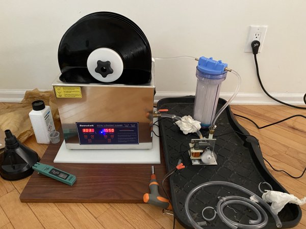

* Brand new pump from pumpvendor, turned on for the first time yesterday with everything connected (I reached out to see what options I have available, since I am past the two week I think I will have to deal directly with Franklin Electric)
* I will shorten the various tubing length to see if that will help
* I am using about 2 gallon of water with 1 1/3 cup of IPA and about 10ml of Ilford fluid.

Thanks for the picture of your setup. Please stay in touch with your progress and questions.

I just put everything together and there is a leak from the pump. I have confirmed that it's not leaking from the input of the output but from behind the metal plate.
How did you stop the leak
Shadowlight - how did you resolve the leaking pump. There are several Little Giant users among us and I think we'd all appreciate learning what happened. Thanks.
Btw - it is being suggested that you enclose the pump for a variety of reasons, one being proximity to the tank full of water. ;)
Yes, I sent the pump off to Pump Vendor and they tested and said they were not able to find any leaks. I guess they tightened some stuff up before testing and when I got it back no leak. Yes, I am going to put that in a enclosure before I move the setup to the permanent location.
