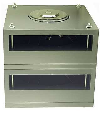

When you need it smaler go get a Ripol sub,can be integrated with horn speakers, upright, stackable. a few building suggestions.
34243-73e2c688.jpgManger-Ripol-Aktivlautsprecher-mit-integrierten-Duo-Endverstärker-und.jpgripol_double.jpg
There are no limits to your imagination, it is important to keep the calculated design. go to Ridthaler website, tell him what kind of woofer you want to use.
He will calculate the exact size of the housing for you. it is patent from him.
View attachment 75254View attachment 75255View attachment 75256
