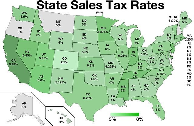

I’m no expert on the US tax system, but it appears to me that import duty free on computers does not excempt the unit from individual State sales tax:

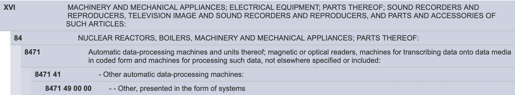

Didn't realize anyone else had encountered this. I thought mine was a mistake given the category it was placed in. And when I spoke to a representative at the CA Department of Tax Etc. they were also surprised, but explained that their process is based on the category chosen by U.S Customs. In any case, the ball is now in their court, and there may still be a payment in my future.
I doubt it was categorized as a nuclear reactor, it’s just that section 84 is titled "NUCLEAR REACTORS, BOILERS, MACHINERY AND MECHANICAL APPLIANCES; PARTS THEREOF”. My guess would be that the HS code was incomplete, for whatever reason, and thats why it only shows the first two digits and not the full code.
Emile is likely correct in that computers are exempt of import duty and therefore most US buyers have only had to pay state sales tax.
