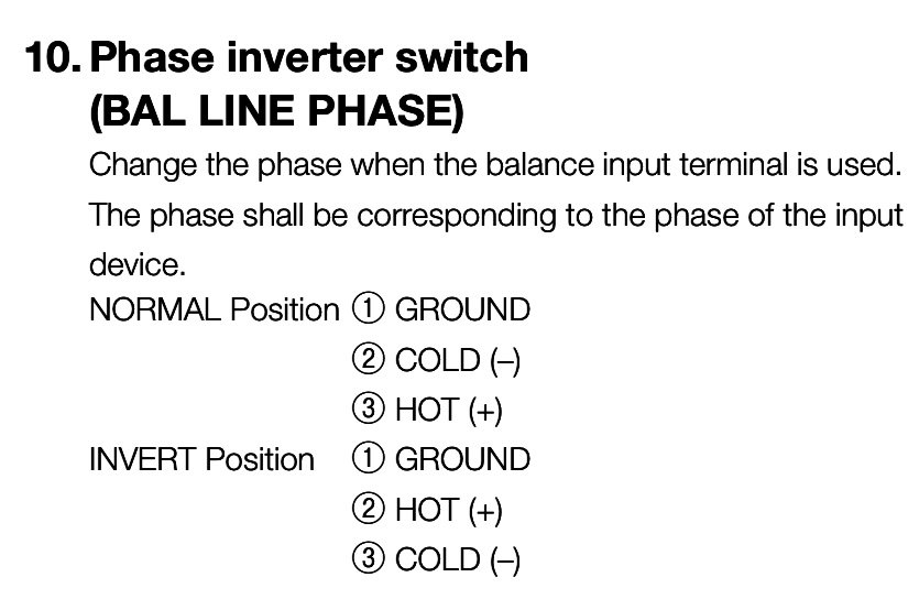

There are two connection schemes.
Regular connection, used these days by most, but not all, is as follows:
Pin 1 - earth/ground
Pin 2 - positive signal
Pin 3 - inverted signal
In the early days, Jeff Rowland and Cardas (and some other brands) used the following:
Pin 2 - inverted
Pin 3 - positive
When connecting an XLR cable to an unbalanced input, you should take the positive signal half and use the neutral/ground (always pin 1) for reference. The inverted signal half will then not be needed.

...quick note: this scheme is still *currently* used, notably in Japanese components. From Luxman User's Manual:
Indeed, there are exceptions, Accuphase being indeed one of them (and apparently Luxman as well). But even though Luxman refers to pin 2 hot as inverted, most EU and US companies nowadays use pin 2 for hot.
