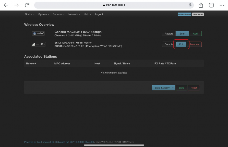

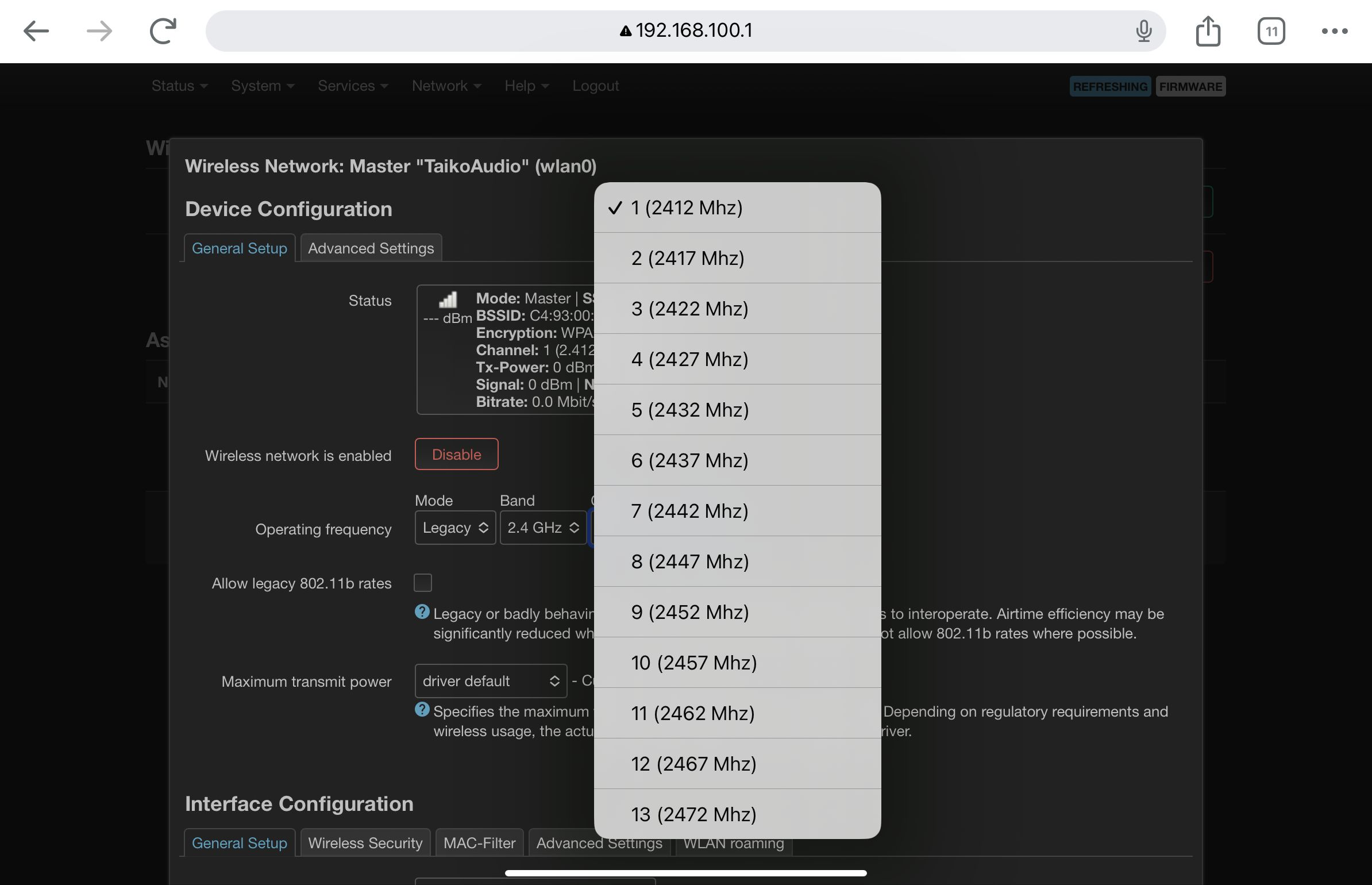

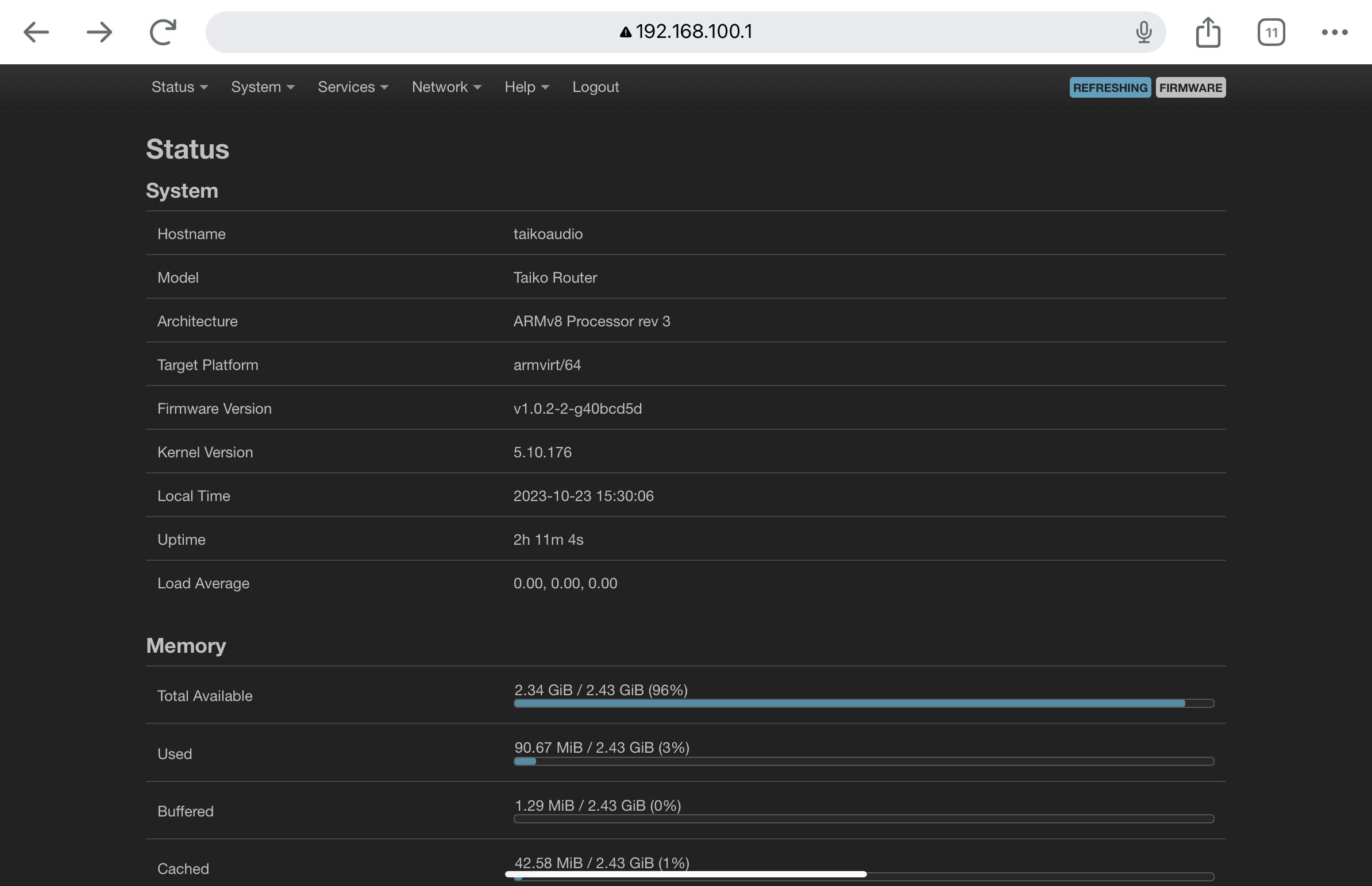

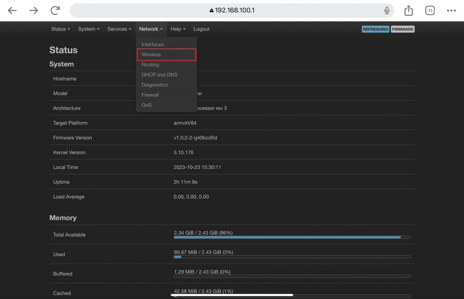

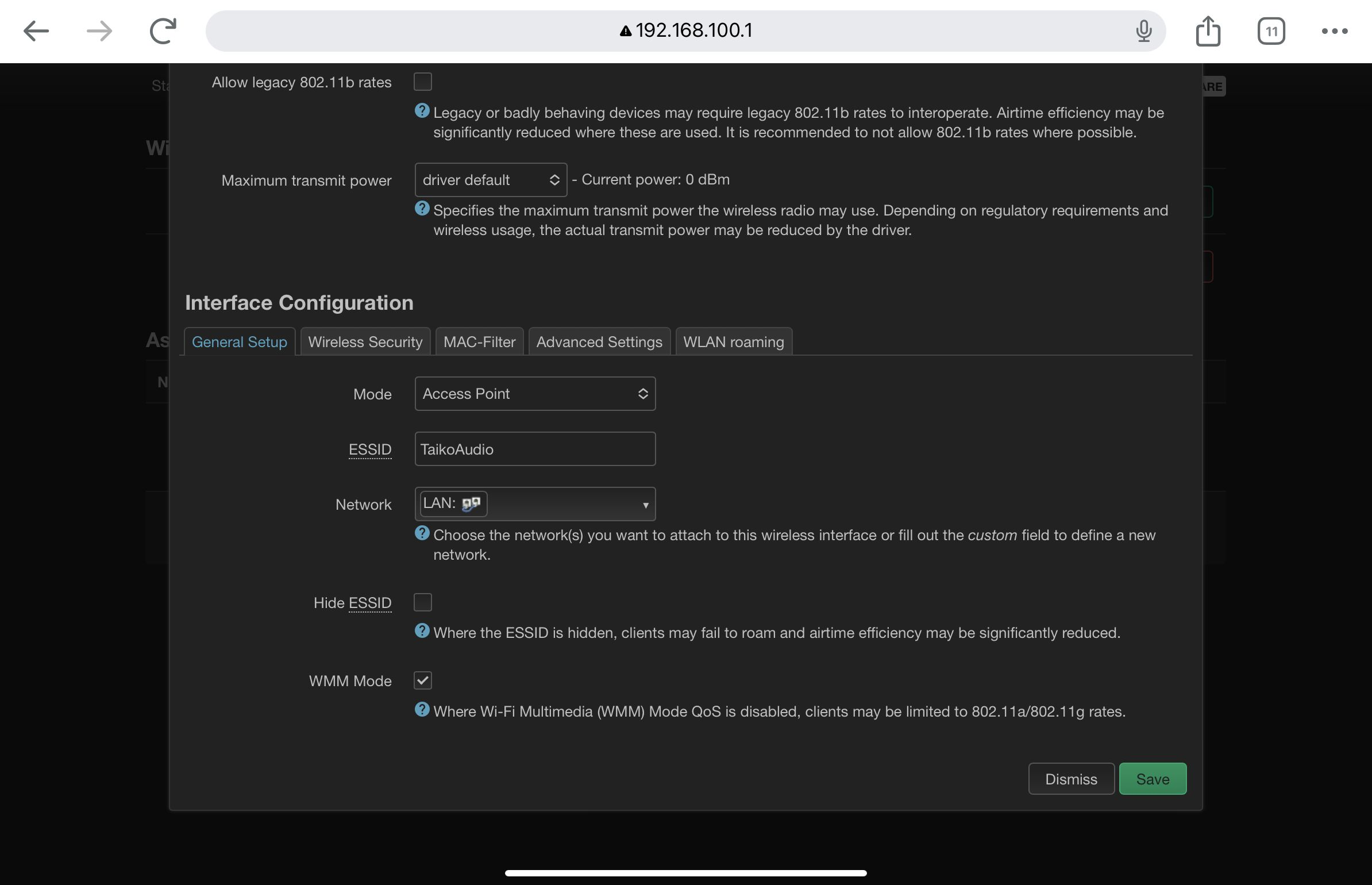

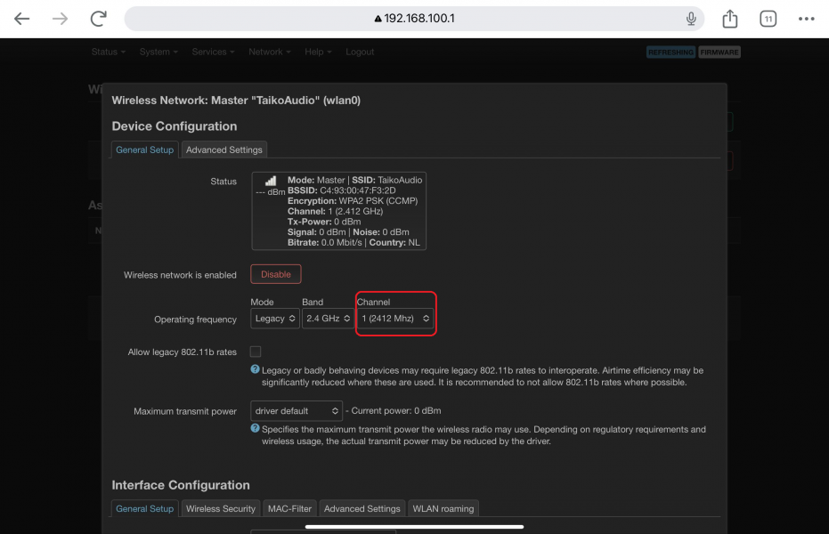

How to change Channels on the Taiko Audio Extreme Router
(also to be added to the Router Manual later)
Log in to the Router's Web Interface. This takes you to the main page:
Go to Network - Wireless
Tap "Edit" under Wireless Overview, second row
In the screen that pops up next, tap ‘Channel’
This produces a popup list
Choose your desired channel, scroll down to the bottom and tap Save
