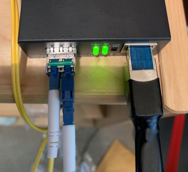

The Startech 80km sfp modules do not come with a warning that they require attenuation on short cable lengths. But yes we are using them out of “spec”. Mine are still “alive and kicking” after a year or so of 24/7 usage though. Fwiw I don’t like using attenuators either, causing a reduction of ultimate stagesize and dynamic reach in my system.
I'd like to thank you for your recommendation of the Startech SFPs, etc. I'm delighted with the sound quality improvement I got from these products.
I did find out that I was initially using attenuators incorrectly - and it made a difference. They are supposed to be used on only the receive side only, as pictured below. I thought I had to use a pair per side since the duplex connector was a single piece. Thanks to assistance I received on the AS forum, I learned the legs could be split out of the duplex connector.
Using too many attenuators or too much attenuation seemed to detract from the music. Using too little attenuation was problematic in my system though - but primarily with lesser recordings. I could happily live with what I'm hearing from 10 dB per side, but will likely revisit this over time as I improve my digital source.

This is pretty confusing. How does one know which side of the fiber duplex is the receiving and which the transmitting? Your picture show it to the right side when looking down. So, are you saying the attenuators should only be on the right side (if that is the receiver side) at both ends of the cable?
Further confusion from Startech, they seem to refer to "transmitting" and "receiving" to mean transmitting at the switch end and receiving at the server end, which has nothing to do with the duplex...
"So in this case one would be the transmitter on the network switch and the other would be acting as a receiver in the network card on the server."

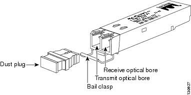

I’m pretty sure that SFPs adhere to standards that govern physical layout so that one manufacturer’s products can interoperate with another’s that meet the same standard. I found this on Cisco’s site, but assume it applies to Startech as well. This was consistent with an illustration on Wikipedia as well.
