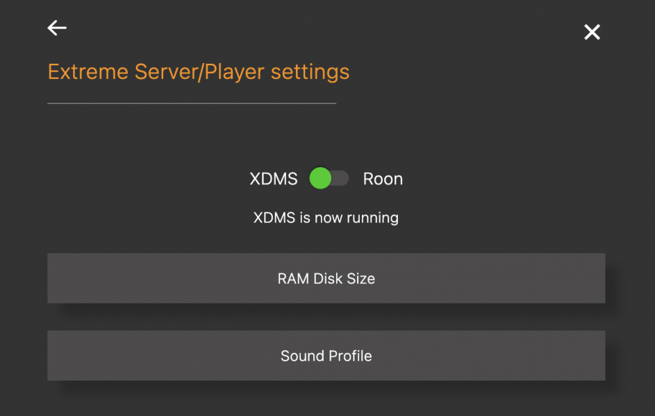

Yes, you can switch back and forth between having XDMS runiing or Roon running from the XDMS App
Is this now a simple toggle in the app? I ask because last time I inquired on this topic, I was told it was not that simple. I use my Extreme not only as a server for my main rig, but also as a source for a HT system and the distributed audio system for the rest of the house. These other two use cases require roon, but I would love to install XDMS if it is now easy to swtich between that and roon.
Reactions: PhoenixRising
Yes it is. Painless and easy.

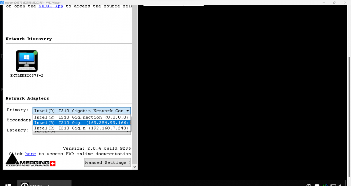

Hi Emile, Tomorrow I will be receiving a second network card and an RJ45 SFP module in order to connect my Merging NADAC to the Extreme. I will be installing the card in slot 5, replacing the Taiko USB card currently residing there. I will test both switch configurations and let you know what I find. However, when I receive the router will placing the switch between the network card and the Merging still be an option?
Yes no problem!

Unfortunately, when I connected the second network card in slot two, the Extreme doesn't recognize it as an Ethernet port. Here is a screenshot of ipconfig from the Extreme. The three ports shown are the two LAN ports and the network card in slot 5. So when I connected it to the NADAC DAC, the driver didn't list it as an option for the connection. (See second attachment)
Can you contact support@taikoaudio.com so we can schedule a remote support session to have a look?
Thank you for the info and the response. The card in slot 5 shows up, but not the card in slot 2. When I connected the switch to slot 2 using the DAC, the Roon core was discoverable by Roon but it was unstable.
I just tried it again, moving the DAC cable connected to the switch to port 2 from port 5. The Extreme is not discoverable on the network and there is no Roon core available.
