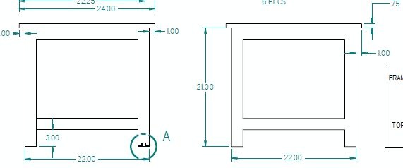

Unfortunately I can 't find any decent images of these isolation tables, especially the inside of the mechanical unit.
The specifications are quite good, but a bit too generic.
Here's a sketch with some more dimensions of the stand;
