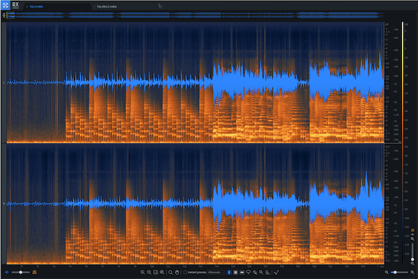

This is from a Sonix IV 60kHz, bottom-firing tank. Something side-firing like the Degritter is likely better.
Edit - Delete - What is the depth of the tank from the water level to the bottom of the tank? I missed your prior edit showing that the record is ~1.5" from the bottom.
Did you reclean the records with your vacuum-RCM and then recheck the record?
What are the records name/label/age you are showing?
Where you using just DIW in the UT tank?
Did you measure the tank temp after 24-min?
For the before UT measurement was these just cleaned with the your vacuum-RCM?
For the after UT measurement was these the only records cleaned, or had other records been cleaned previously with the same bath?
Yep, should be roughly 1.25" to 1.5" from tank bottom.
Not yet. Just got back from a trip, so I'll try this as time allows, just in case.
Yaz - Upstairs at Eric's, side 2. Would have to check the specific stamper, but seems like an original (if not "first") pressing from 1982.
Distilled water with AIVS Enzymatic Concentrate for Ultrasonic Machines, diluted to suggested level. As stated, I did also follow it up with a rinse pass afterward.
No, but I'd started at 80F, so I assume end temp to be about 90F.
They'd been cleaned a few days prior with the Liq/rinse/Liq/rinse/Terg/rinse process. The double initial wash was due to what looked like remaining oily marks after the first cleaning pass.
I washed this record on its own rather than with a second record, yes, out of a hope that I could limit the number of records damaged and offset any potential for overloading the tank with too much to clean. I guess it had the opposite effect.
As I said in my previous post, I had to do a separate rinsing cycle after adding 2ml of Degritter solution due to excessive (to my eyes) foaming. I also washed Degritter with several short cycles and one maintenance cycle with fresh DIW before starting medium cycles with records for rinsing. And immediately I noticed some foam in the water and on records as I was rinsing them! So, if you switch water tanks as Degritter recommends, you would have even more cleaning substance getting to your rinse tank with each cycle.
Thanks for taking the time answer all my questions.
The dilemma is trying narrow down what caused the increase in noise in the outer grooves. It easy to blame the UT, but that may not be cause or the only cause. But, @rDin who has and has used the Kirmuss UT ~6.5-L machine which is 35-kHz and ~180-watts (the Kirmuss does spin faster ~1.5-rpm) for single record cleaning in his cleaning regime as pre-clean step before his Degritter and has done spectral analysis same as you, to my knowledge never saw the difference you saw with 60-kHz and 100-W.
*Was the record composition a contributing factor? Here are the Discog details of the record - https://www.discogs.com/release/2447172-Yaz-Upstairs-At-Erics. Some records can have various amounts of regrind; and depending on the quality of regrind the composition/properties of the record can be different. Some very poor regrind that is sourced from returned records can have pieces of the label (the machines punching out the labels were not perfect)- you can often see this with UV light - the record shows up as is a kaleidoscope of colors. But there is discussion in older magazines where pressing plant managers said that ~10% of regrind made for a better pressing but caveated that by saying when they used their own regrind from records they pressed of similar composition.
*Was the enzyme cleaner a contributing factor? If you reclean the record using your vacuum-RCM process and the noise goes away, then the enzyme was the likely cause. If the noise does not go away, that does not absolve the enzyme cleaner, since the record composition could be a contributing factor. The enzyme protein could have found something in the record composition to breakdown. I can't say that this likely, but how enzymes work can have unpredictable results.
Please keep us advised of what happens when you reclean the record with just your vacuum RCM process.
Take care,
Neil
That's indeed the closest listing I can find for my copy. Side 2 has the "SPAR" part in very faint etching in the runout groove. I just did a second cleaning with just the Tergitol 15-S-9 0.5mL/L dilution followed by a rinse pass. Looks pretty much identical to the "after_ultra" file. So that noise is there. It's not extreme enough to be unlistenable, but that ultrasonic cleaning definitely added background hiss for the first few seconds of the album. Ah well, it wasn't an expensive copy, nor particularly rare (unlike the promo pressings I've ruined with boneheaded heavy-handed cleaning).
Don't know if the enzyme cleaner would be a problem. If so, wouldn't that be a problem throughout the record rather than just the outer grooves? I used the recommended dilution level from AIVS, so *shrug*.
It does seem at this point that it would be wisest for me to just stick with the now more reliable Liquinox and Tergitol dilutions, and if 2 cleanings doesn't take care of it, just move on and accept that I'm not going to get more out of the record. It's tough for me to do, when I've gotten improvements in the past after switching up my cleaning solutions, but it seems this is as good as I'm going to get at this point.
