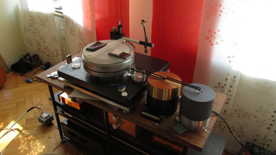

There are two possible ways to minimize control interventions on the motor. you add a large flywhell to it. or you can set the motor to constant load operation.

Keeping steady speed at 33.3rpm and w&f performance are two different things. Another very important problem for all drive types is aggressively trying to keep 33.3rpm speed by control electronics. That aggressive control may achieve 33.3rpm average but for the cost of increased w&f.
Hmmm ... I don't understand this broad pronouncment. Unless you see wow & flutter almost entirely as a symptom of increased vibration/resonance rather than a symptom of unsteady speed. Extraordinarily high correction rates (multiple thousands of times per second) are less aggressive not more because they are effectively constant. Imo, the advantage of stable accuracy go beyond low wow & flutter numbers.
This describes my turntable. There is. 10 lbs flywheel on the drive pulley, and the motor sees a constant load which is user adjustable. One can adjust the string tension and then the load to arrive at what sounds best.

Not sure I buy the constant correction argument. It’s a bit like the claim that if you can just use enough negative feedback it magically cleans itself up and you get perfect sound. The argument that using higher amounts of the thing that causes the problem will solve the problem seems to me not to be logical. Putseys from N-core and Purifi claims this for his amps and now you have made that argument for TTs (Grand Prix audio’s argument for their speed correction?).
Think bigger 40lbs at 800rpm;)View attachment 124656

Very impressive fly wheel indeed. I suppose the precision of the fly wheel have to be the possible most accurate as it has to be the rotation balance otherwise shall introduce unbalanced waves to the play back sound.
I suppose the system is working well, therefore congratulation for implementing it.

Thanks, platter bearing and flywheel was a final thesis by mechanical engineering students who put a lot of effort into it.
sometimes you have luck in life to know the right people
